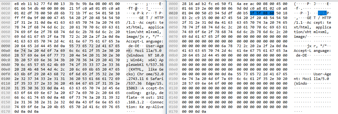

    But i have the Problem that the packets i receive with sl_Recv() are cut off. The Buffer and packetsize while receiving are definitly big enough. sl_Send works without problems with bigger packetsizes.
    I have looked with wireshark what my PC is sending and check the received package with system_Printf(). Its cutted of after 64 characters.
    Are there any known problems with your example?
    When will it official be released in the next sdk?
    Are there more examples with the AMIC110 and CC3120 planned or released?
    I just wanted to ask these questions because i am unsure if the problem is maybe in the terminal example because its for AMIC110 and not the AM335x Sitara directly.

  • Hi
    now i have to add. I implemented the tcpechoexample again and i see many zeros between the words coming back. Left is what i send and the right side what i receive.
  • I found the problem in the cc_pal.c in the spi_read function.
    read_size += transact_details.count;
    len = len - transact_details.count;
    transact_details.rxBuf = ((unsigned char *) transact_details.rxBuf + read_size);
    The third line is just wrong. The incrementation will grow too big and we have empty characters in the buffer given to spi_read.
    rxBuf will already be incremented and we overwrite it. If we would add the read_size to the pointer given to the function it would be correct.
    In spi_write its correctly implemented
    transact_details.txBuf = ((unsigned char *) (transact_details.txBuf) + transact_details.count);
    So i had to change the third line posted above to:
    transact_details.rxBuf = ((unsigned char *) transact_details.rxBuf + transact_details.count);
    I really wonder that nobody had a problem with that before.
    I hope you get what i mean and i do not describe it weird. But i think you will see what i mean
