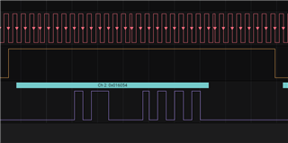

  • Hi
    can you help confirm the signal i marked below.
    point1: confirm is there pwm signal, when you playing music, does the duty cycle change or not.
    if duty cycle of point1 doesn't change, then confirm point2 is there i2s signal been input to the chip.
    2) If I take the same init code and I use it to configure another design based on the same TAS IC I have sound.
    here another design using same IC, what about surround circuit of another design? are they the same?
    thanks.
    Jesse

  • About #1 I have a 50% duty cycle even when sound is playing at around 387kHz. I2S signal is present.
    If needed I can provide a capture.

  • Yes I have no sound, but I2S bus have valid data on it.
    PWM is there but is always set at 50% duty cycle.
    Company is going to  summer vacations, I can see if I can do some last tests tomorrow.

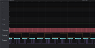

  • Hi
    i am afraid that i don't have the tool logic souite.
    can you share me a screen shot.
    thanks.
    jesse
  • Unfortunatly this week i'm out of office, and looks like that the attached dump on first post is incomplete, it only contins the PCM9211 initialization.
    Next week I'll provide a screenshot when can I access the right file.
  • I'm back to office. This is the sequence.
    The full init sequence captured by the logic analyzer:
    -- OSC TRIM --
    write to 0x1B ack data: 0x1B 0x00

    This is the logic capture of the I2S bus. The MCLK is out of the range of my logic analyzer.
    The BCLK  has an some sort of periodic artifact, but I cannot see it in the scope. I think that the issue is with my capture device (long probing cables and bad ground.
    BCLK, MCLK (is quite near my SCOPE limit), WS, SDIO:
    All the signals are around 3Vpp (1V/DIV). MCLK and BCLK had a .4us/DIV, while the WS was at 20us/DIV.
    BCLK VS WS (1V/DIV 2us/DIV):
  • Hi
    I tried your code, it doesn't work on our EVM board, i am not very sure it is format issue or the code issue.
    But I used our EVM board and configured a default setting.
    it worked and initial file was dumped.
    can you transform the cfg file attached to your format and take a try whether it work or not?
    /cfs-file/__key/communityserver-discussions-components-files/6/i2c-initial-file_5F00_nomute.cfg
    if you have our EVM baord, you can also use below link setting file to confirm the setting.
    /cfs-file/__key/communityserver-discussions-components-files/6/GDE_5F00_file.zip
    thanks.
    Jesse
