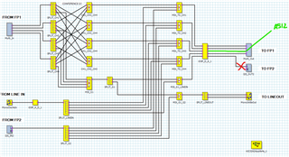

    Actually i shared a simplified PPS, my real problem is with the following PPS with a similar issue :
    Even if I2S_OUT2 is not connected (red cross), i have audio from other source to ASI2 thanks to the third channel of ASI1 (in green).
    Despite this, the rest works fine :
    • Multi_In to Multi_Out : OK
    • MonoDec to Multi_Out : OK
    • I2S_IN2 to Multi_Out : OK
    • MonoDec to I2S_OUT2 : OK but cannot be muted with MIX_G1_LINEIN
    • Multi_in to MonoInt8xOut : OK
    Thank you for your help

  • Hi Sebastien,
    I discussed with one of our DSP experts and we found that the multi_digital_out block is sharing resources with the I2S_2 block.
    In short, the DSP has 4 stereo "ports" to interface the I2S data to the output pins. The multi channel block interfaces with all of these ports while the I2S_x blocks interface to only one of these stereo ports. When you use both the multi channel block and the I2S_2 block, they are both accessing port 2 which is why data is appearing on ASI2 from channels 3 and 4 of the multi channel block as you highlighted. Using I2S_3 ensures that each port is only connected to one output.
    What you've encountered is just a limitation of how the DSP was designed as well as being limited to 8 channels (4 ports). When you try to go to 8 channels, I2S_2 and 3 will be sharing ports with the 8 channel block, so ASI2 and 3 will have copies of channels 3&4 or 5&6 respectively. It was assumed that a full TDM bus would not need the other I2S headers since all 8 channels would be present on one data line already.
