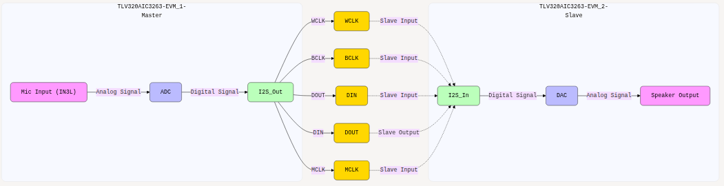

I'm working on a project where I connect two TLV320AIC3263EVM-U boards using the I²S bus.

In my case, I did not share a single MCLK source between the two EVMs, and it still worked.
I also tested the setup by removing the JP49 jumper on the slave EVM and connecting its pin 2 to pin 2 of JP49 on the master EVM (configured for MCLK output via pins 2–3). This effectively shared the master’s MCLK between both boards using an external wire — and it worked without issues.
I’m wondering if this is reliable, or if it might cause subtle timing issues down the line.
Wrench Setup Details
Since my previous topic was closed, I’m sharing the working setup and code here for future reference:
Pushpin Previous topic (with background):
 Link TLV320AIC3263EVM-U: Communicating Two EVMs via Mono PCM
Electric plug Connection Setup:
I removed J17, J18, J19, J20 jumpers on both boards and manually connected the middle pins (pin 2) as follows:
Master Pin Slave Pin
J17 →  J18
J18 →  J17
J19 →  J19
J20 →  J20
This configuration allowed me to transmit and receive audio between the two EVMs successfully.

Headphones I²S Master Code: Bi-Directional Audio
With the setup below:
  • You can send microphone input from the slave device to the Class-D speaker on the master.
  • Simultaneously, you can send microphone input from the master to the Class-D speaker on the slave.
I will share the full working code and connection details to help others searching through the forum — since it was quite disappointing to find many unresolved topics during my own research.
Let me know if anyone has suggestions regarding the MCLK setup or notices any potential issues with using independent crystals.
Thanks again for the great support from the community!
