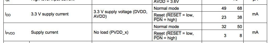

To clarify you are running the TAS5731 at 18V and using a boost converter to regulate a 12V supply to 18V?
Do you know what the efficiency of your boost converter is? I believe boost convert efficiency can vary between 70-90%. Your calculation assumes 100% efficiency, but 70% efficiency puts you below 50mA of current at 18V so I think this may be something to rule out. Is it possible for you to measure the current directly into the TAS5731 at 18V?
Also are you using the same conditions used by the datasheet? TA = 25°, DVDD = AVDD = 3.3 V, RL= 8 Ω, BTL AD mode, fS = 48 kHz. Is it possible that you are using the device with a smaller load? Clarifying these test conditions will help us rule out potential causes for the higher current you are observing before looking into the schematic you are using.

At 90% efficiency for the LM3488: 100mA*12V/18V*.9 = 60mA current draw by the TAS5731 so you are right that this is a bit higher than expected. You said that you are running with a 4ohm Woofer & 8ohm Tweeter on each channel. The datasheet current readings that you referenced state that they are for "no load". Having those loads connected could be causing the additional current draw that you are experiencing.
