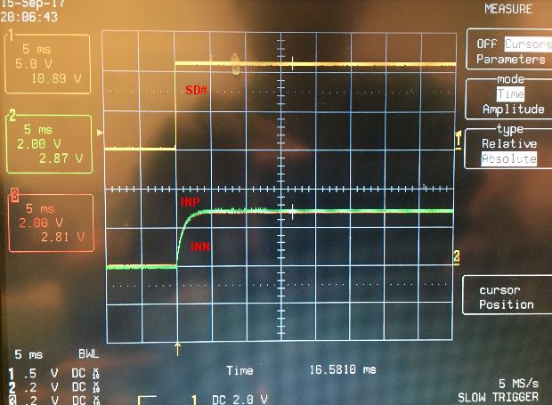

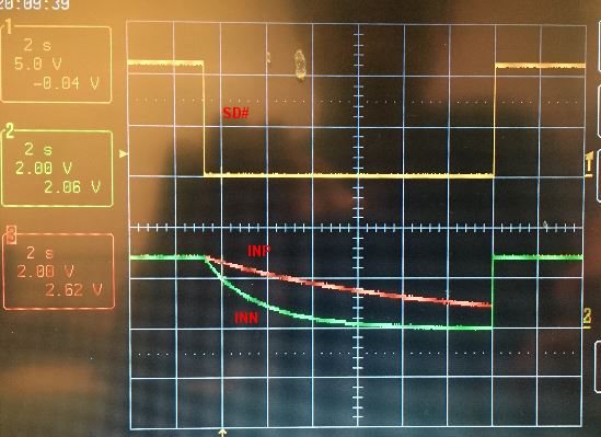

Would you pls advise if it is a normal behavior to have different discharge time between INN and INP?
Power Up: First time power up. INP and INN rise at the same slew rate with less pop noise.
Power Down: INP drops slower than INN, it makes pop noise during next power up.

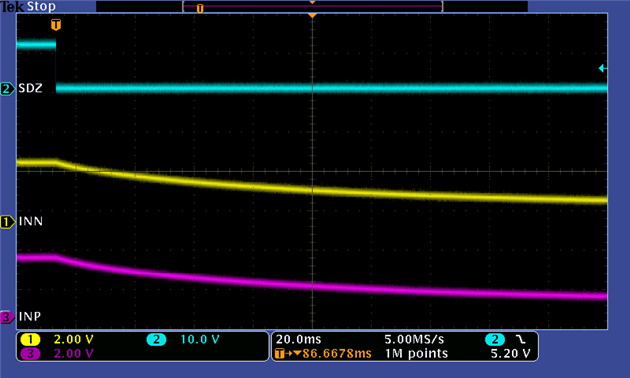

This is strange. If the both input(INN/INP) are connected to GND by 1uF capacitors, the behavior should be the same. Please find the picture below which is captured by scope on TPA3110D2 EVM. You can see that the waveform for INN and INP are almost the same. Could you please double-check the input circuit?
