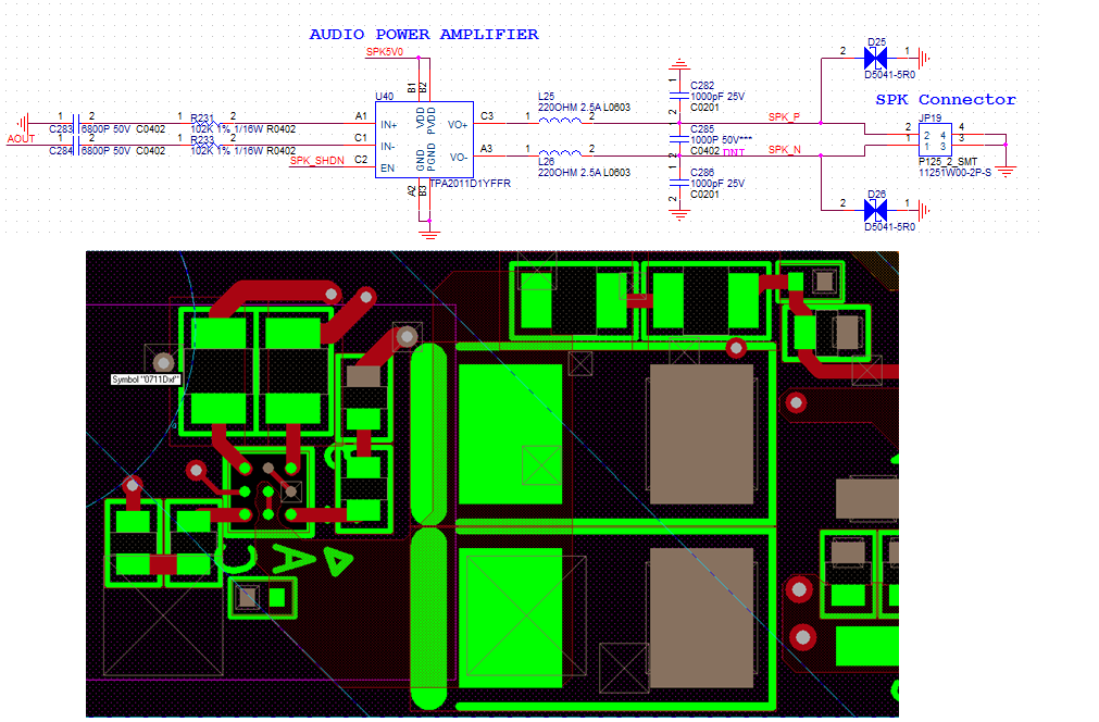

Hi E2E,
Could you kindly review circuit and layout of TPA2011?
Thanks!
  • Hi Julian,
    I'll add some comments below:
    • Common mode filter capacitor is not needed for this device, so you can either remove or keep C385 as DNI
    • I can't see decoupling capacitor on SPK5V0 in the schematic, you should at least place a 0.1uF capacitor close to the device, if possible add a 10uF along with 0.1uF

  • Hi Ivan,
    Thank for your support!
    About layout, Do you have any suggestion?
  • Julian,
    The layout is looking good. I would keep short traces at the outputs but I think the speaker connector is not visible in the capture.
