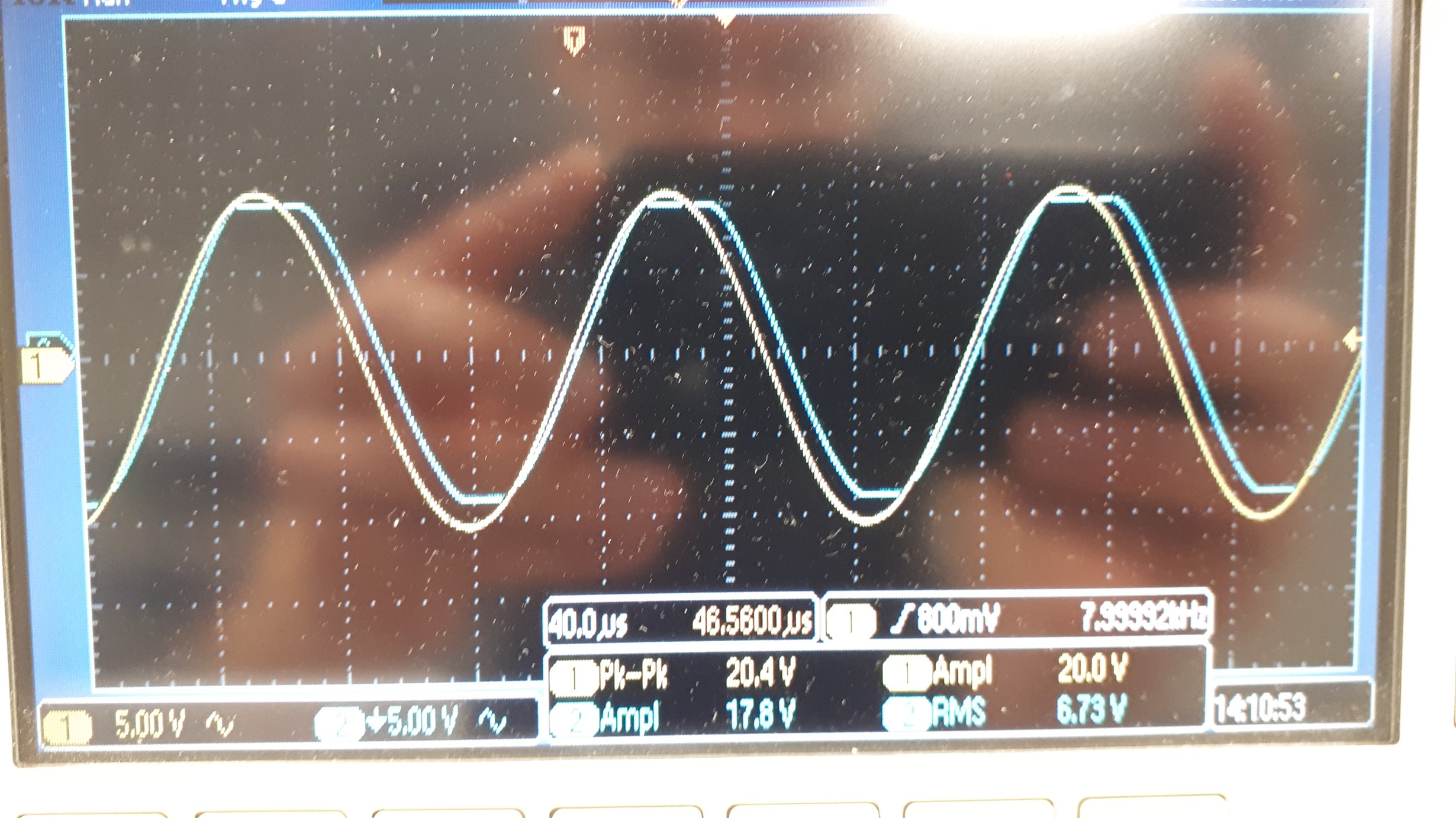

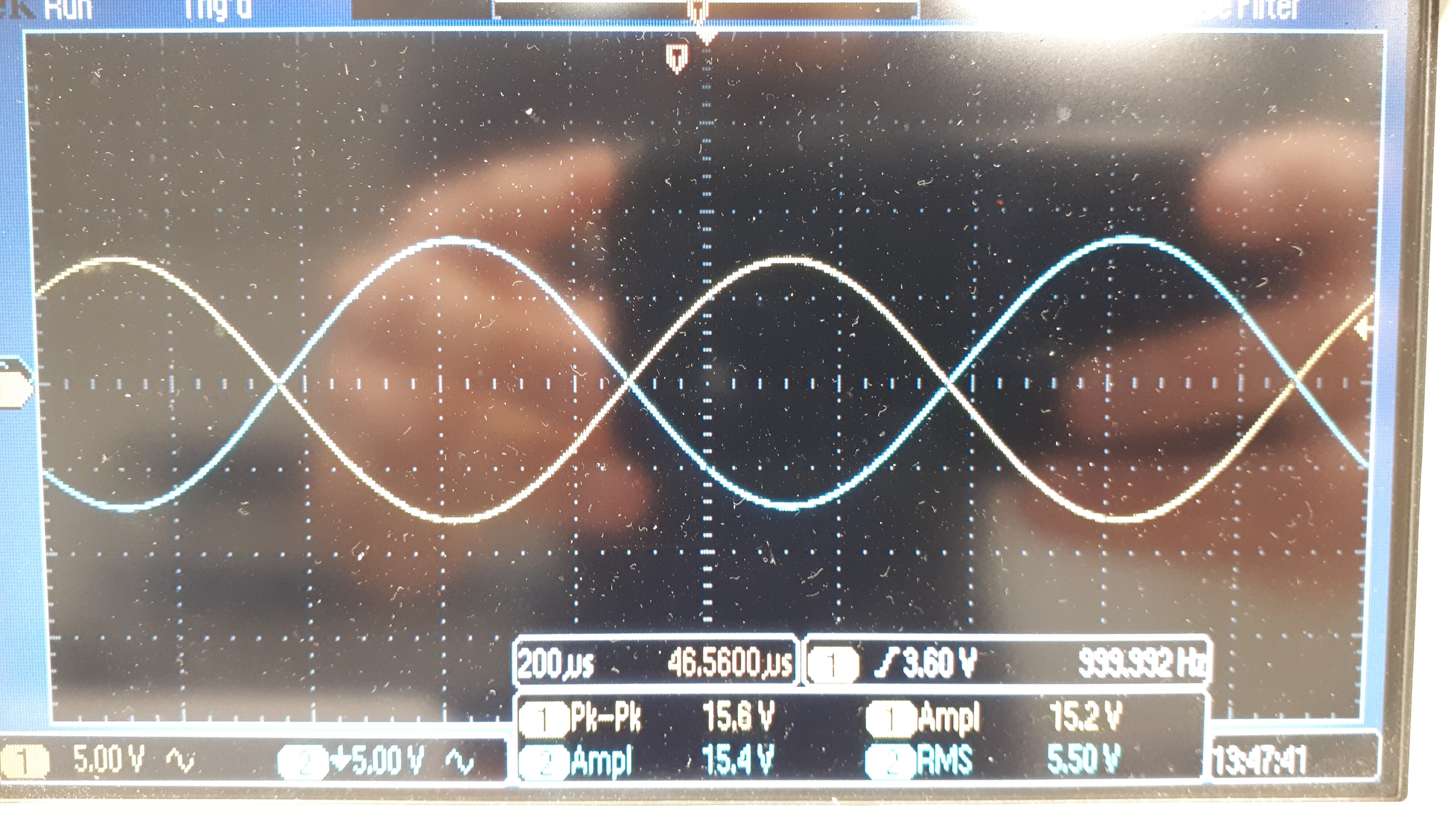

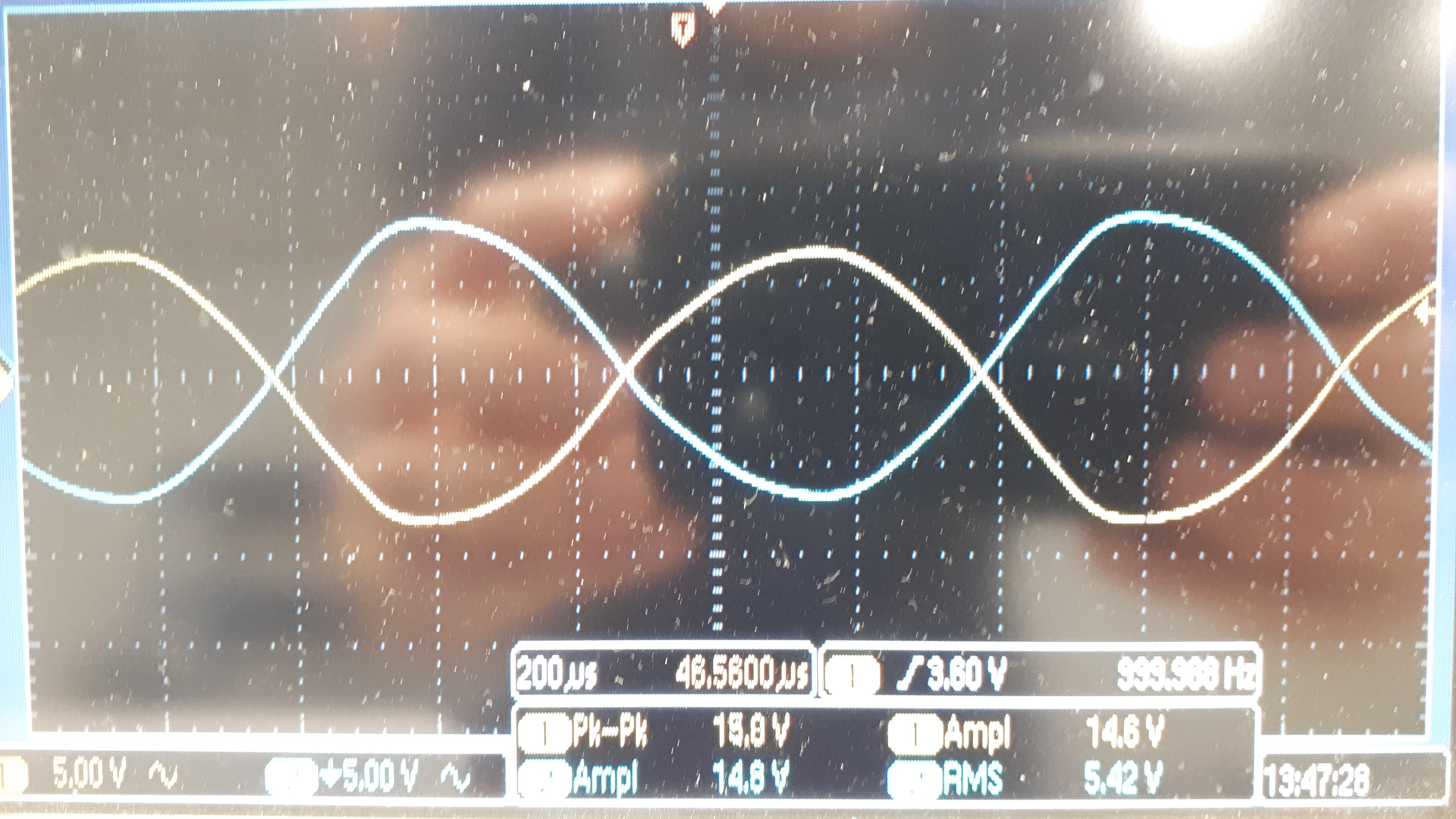

  • I have attached an image with capacitor in + input and without. There is a slight distortion, interestingly on both signals, input and output. I kind of remember it being worse before.
    Actually another question arised. The TL0742 seems to be clipping the signal at around 17-18V. Even though the supply voltage is 24VDC. If I disconnect the TPA6120 from the preamp(disconnect R37), the clipping disappears. Any idea why it happens? Is TL0742 a right type of opamp to drive TPA6120?
    See following picture, yellow line is TL072 invering input(through 20k resistor), and blue line is TL072 output (left side of R37).
    The TPA6120 is sensitive to parasitics and distortion & oscillations can be expected without proper layout. Please note section 12 of its datasheet.
    In regards to the TL074, if you take a look at table 6.21 of the datasheet the output swing has a minimum of +/- 10V for a +/-15V supply. By reducing the load further to 1kohm this swing can be reduced even more. The upgraded TL074H seems to be able to swing a lot closer to the rails.
