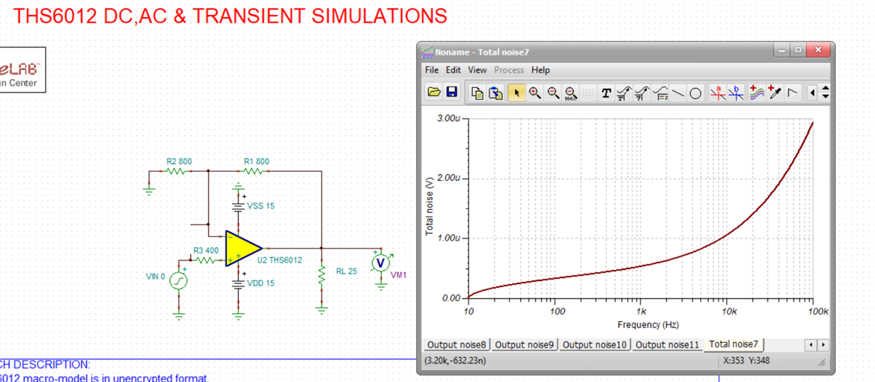

So I am parsing some of the specs for this part for some folks asking for help. I believe this is the THS6012 which is useful as that part has a TINA model and this part does not.

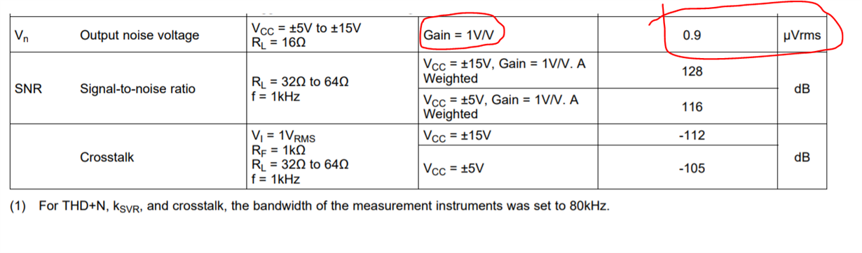

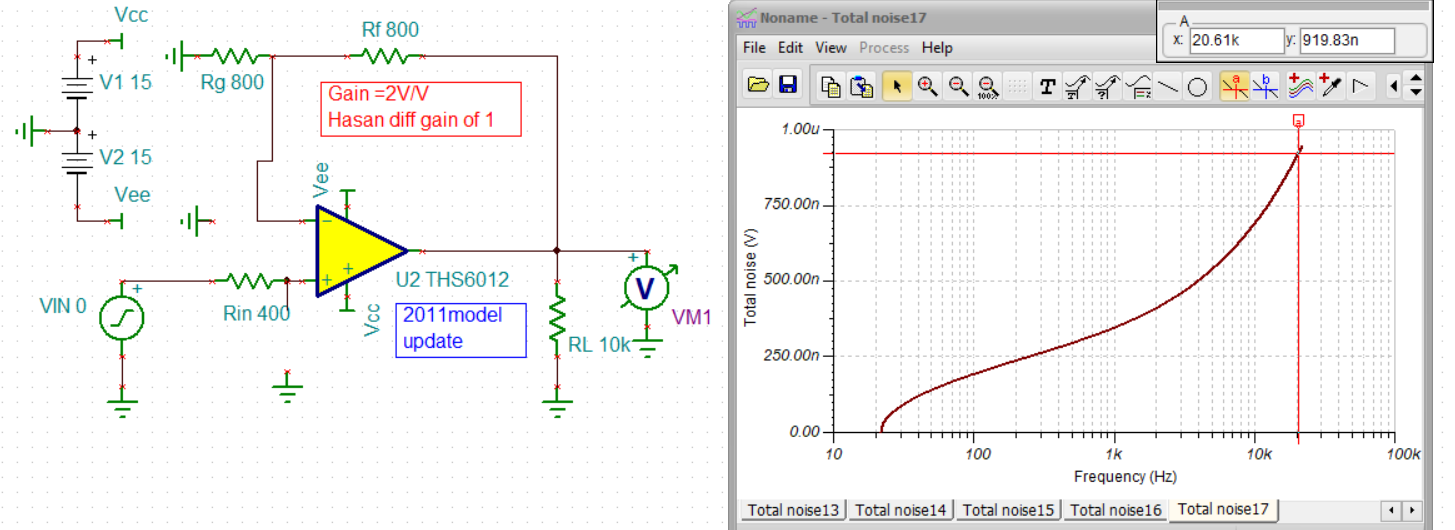

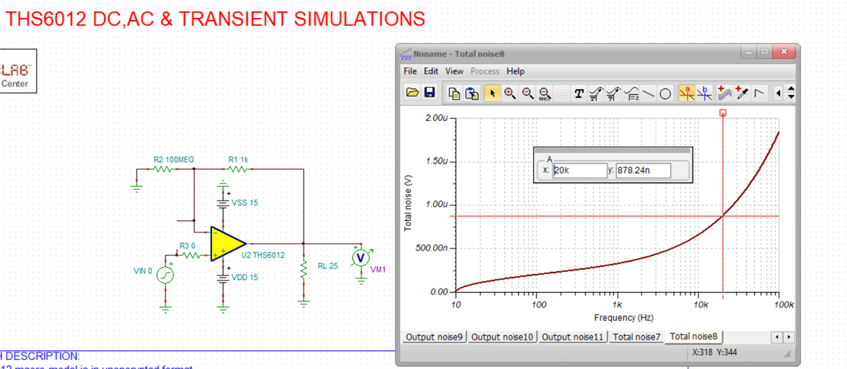

Anyway, working on the noise right now and I am wondering if anyone knows the test conditions for this 0.9uVrms spec line? specifically, the Rf value and frequency span of integration? I am assuming the V+ input has zero source R for this, but if not - what is that value? Originally, I thought the span might be 80kHz given the footnote, but the sims don't seem to support that.
