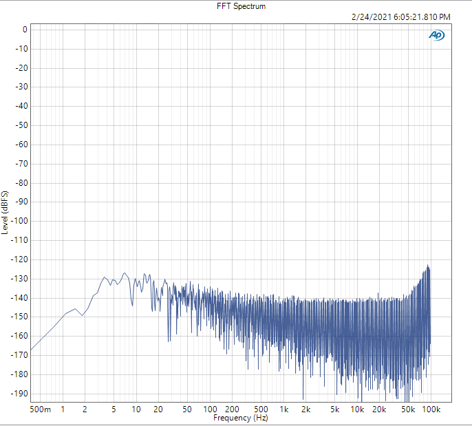

  • Hi James,
    I don't think I was able to reproduce quite what you are seeing but am attaching some data for reference. I measured an FFT on the device running at 192kHz with a TDM256 interface. The noise does start to increase above FS/4 in this case, but I'm not sure if this is quite the same as what you are seeing. If it is, then this is a characteristic of the device filters at these higher sample rates.
    Zak
