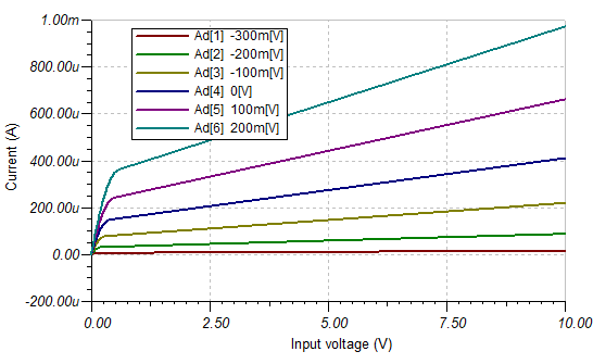

  • Well the point of this simulation is to understand the circuit shown by TI and the claim about "potentially reducing distortion", which makes some sense to me because VDS is kept constant (blue line), so there wouldn't be channel-length modulation:
    But I guess there is another form of distortion that is stronger here?  Or maybe the red line really is just more linear for this type of JFET?

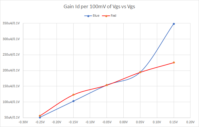

  • Jonathan,
    I extended your red and blue lines then calculated the gain (delta drain current / delta Vgs) over each 100mV of VGS change.
    In the math generated plot, the gain of the mic is not linear. Non-linearity is not good for THD.  The DC operating point matters.
  • In an electret capsule, Vgs is always 0, and a typical signal is 13 mVpk, so it looks like both curves are similarly nonlinear in that region?
  • Jonathan,
    When measuring THD try not to start at time zero. looking at 2ms to 4ms can be better than 0ms to 2ms. The initial t0 might not be perfect.
    The large majority of the THD is caused by the JFET gain which is  (Vgs + Vt)^2 where Vgs peak to peak is less than Vt. So output will be a small section of a squared curve. It is sort of linear, but not not really linear if looking closely.
    Take away the op amp connection and check THD of just the JFET output and the THD there will be just as high.
    I plotted the DC curve for VGS +/-13mV and subtracted out the DC center and DC average gain to get the non lin error for just FET (no op amp).
    VOUT error vs VIN
