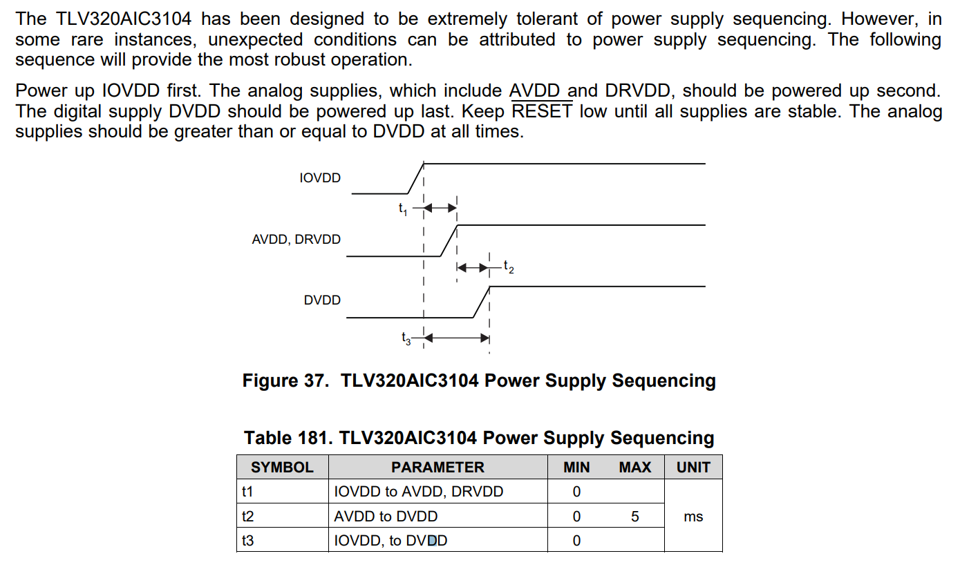

TLV320AIC3104: Is there a max rising/falling time requirement for BCLK for TLV320AIC3104?
Part Number: TLV320AIC3104
My customer is having some EMC issue and found that the root cause for the emission is the BCLK. They try to slower down the rising/falling time of the BCLK and pass the EMC requirement. However in our datasheet there is requirement for the maximum rising/falling time especially when device configured as slave mode(only 4/8 ns as below picture), why so rigid requirement here for the rising/falling time and if any risk when exceeding the required timing?
