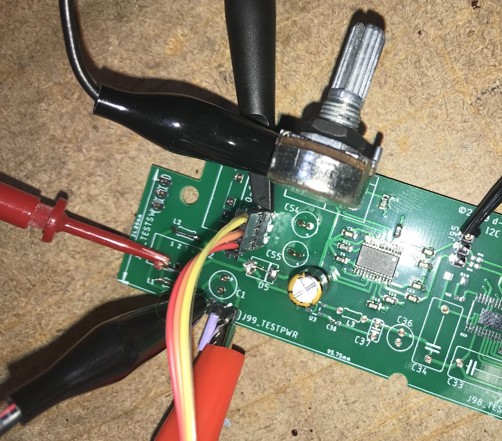

I've attempted a separate board populated only with the amp and it's components.  Current draw was only showing 18ma draw at 5.07v.  The scope measurement is at the audio output jack.  I see the switching and this looks good to me.

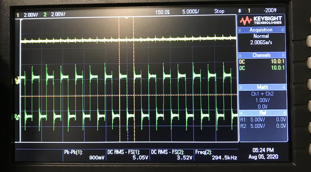

Might there be something with isolation? I noticed also that the DAC output while the amp was off was averaging at 280mV Pk-Pk (see left), whereas when the amp was running I was seeing 1.73 Pk-Pk and pulses at the switching points (see right).

    Also I noticed I had forgotten to mention...  The scope screens in my first post: yellow trace were at the test point between DAC output and amp input on the left channel positive, green trace was on the left audio output positive.

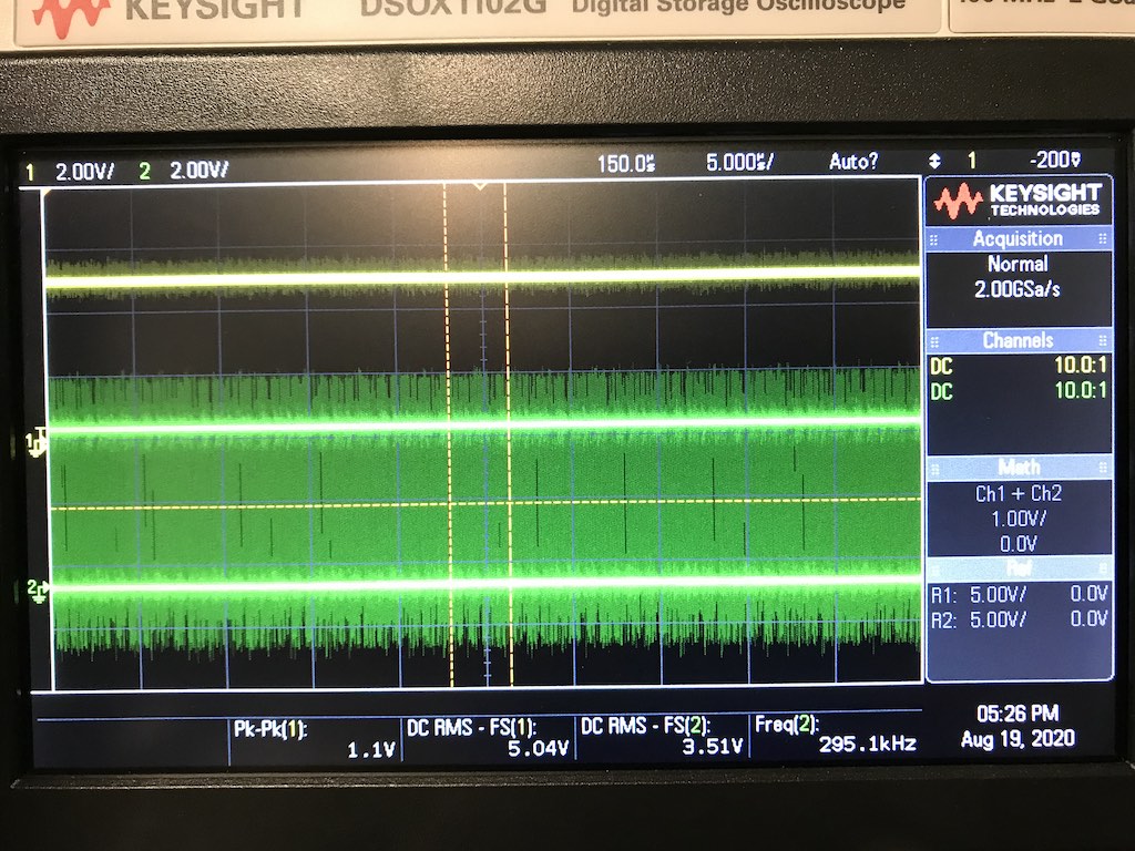

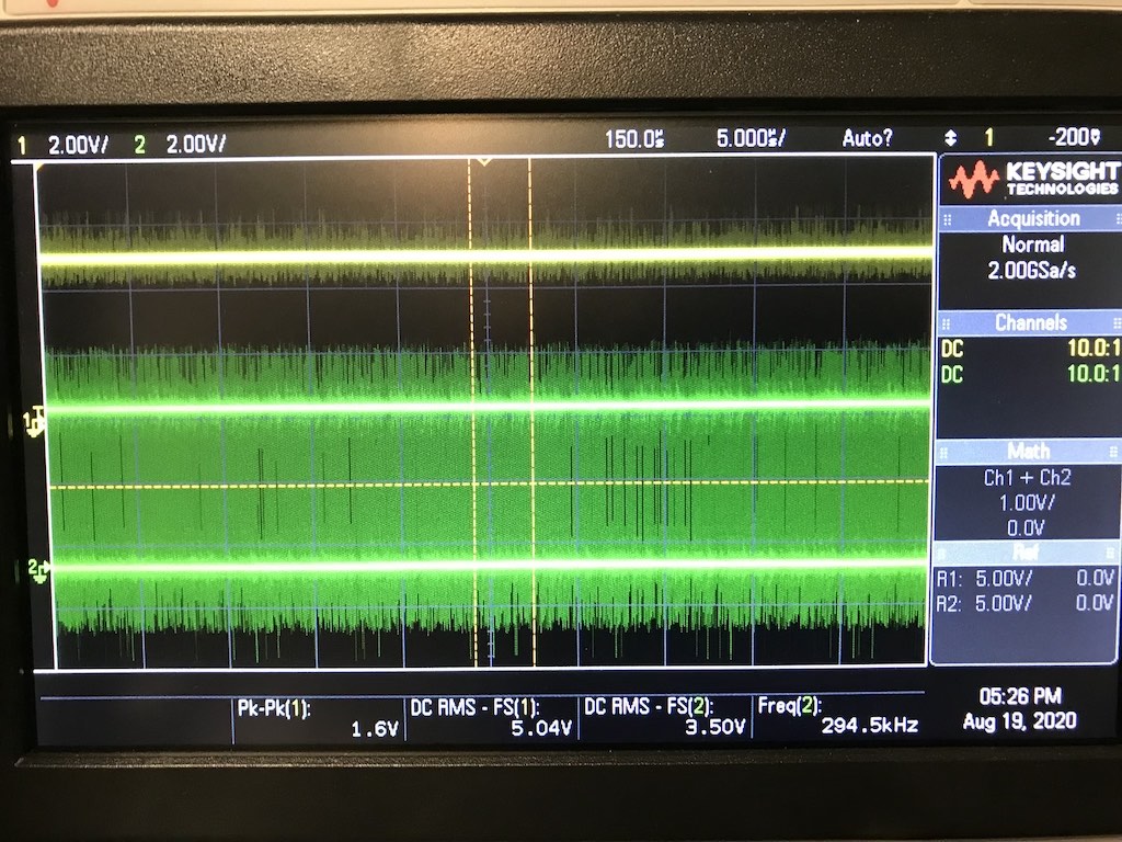

    Ok, so you were right to have me look at the power pin with the scope. Some very strange results here...
    I ran my audio test routine which is spoken word first only from the left, then only from the right, then both channels, and then out of phase on both channels.
    The voltage measured on the scope stays stable at 5.05V the entire time.  The yellow trace in the images below are the 5+ rail and the green is still the left audio output.  First the scope when no audio is playing:
    Once the audio is playing:
    There is indeed noise on the +5 rail when the audio is playing.  I turned off the trigger to try and capture this... there is what seems to be the audio waveform as distortion on the vcc pin.  When this noise gets too high, that is when the amp shuts down.  Playing audio out of just one channel or out of phase stereo both cause this on the +5 rail.  Normal stereo audio does cause some, but very little of this distortion.
    Even stranger, the current draw when audio is playing out of only one channel bounces around between 19ma and 25ma.  When audio is playing from both channels, the current draw is stable at 19ma.
    So this makes sense that when there is too much noise on the positive rail, that it is probably destabilizing the amp oscillation and causing the shutdown.  What do you suggest next?
