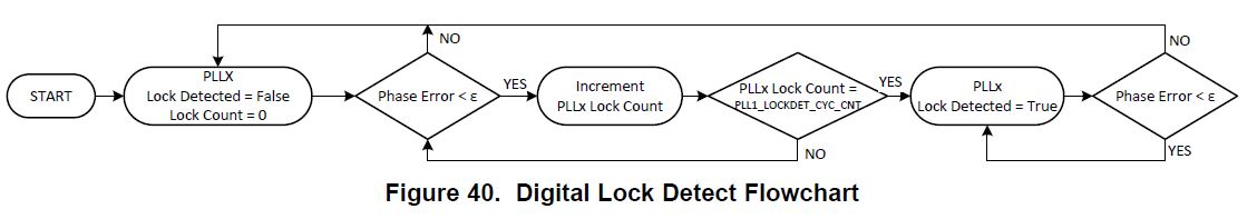

    Something wrong in E2E make no response in E2E. Let me clarify the Digital lock detect signal.
    It is expected in PLL locking.
    As datasheet showed, phase error should be less than a specified window size (ε) for continuous enough times (PLLx Lock Count), one time violation would reset count. If the violation happened after locked, digital lock status will change from lock to unlock.
    In PLL locking, feedback clock phase is tuned to close to reference clock phase, it can have some frequency ringing around target frequency. In PLL locking, because frequency had not been locked, phase relationship on PFD (phase frequency detector) is moving.Ahead, close, behind will periodically happen until PLL locked. When we set a small PLLx lock count, we can saw obvious periodic lock and unlock on digital lock detect status.
    For why large PLLx Lock Count can make a fast lock, I had not thought of the whole flow, but Figure 40 can give some clues.
    Datasheet also shows "Digital Lock Detect Frequency Accuracy", which also related with above figure.
    Hope we can find the cause soon. let us know your thought. I had looped my colleagues in E2E system for more discussion.
