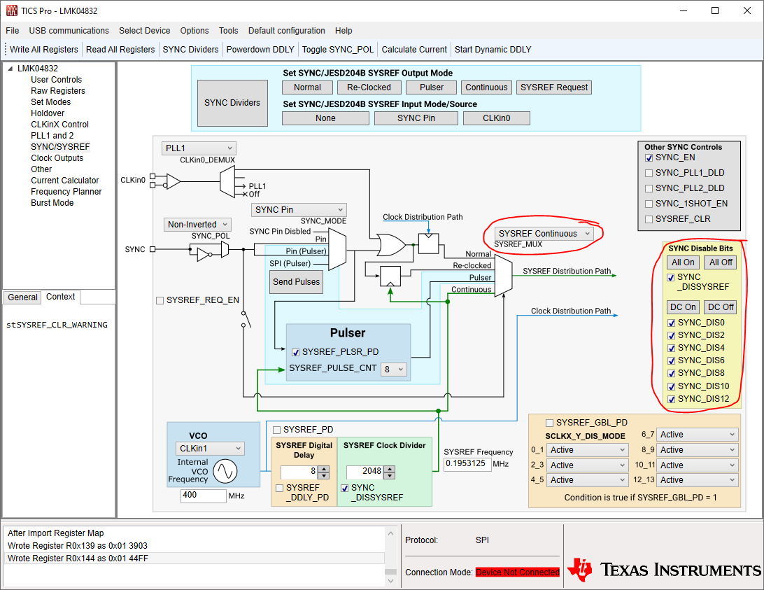

I could yo get SYSREF output from CLKout1/3/5/7 etc.
I've attached register set-up for CLKout1_1_2_3_5 in distribution mode from CKJin1.
Thank you.
  • Hi new2day,
    I'm not seeing your register setup attached. Nevertheless, a few things should be set to ensure SYSREF output:
    • SYNC_EN=1
    • SYSREF_PD=0
    • SYNC_DISSYSREF=1
    • SYSREF_MUX=2 or 3, for pulser or continuous respectively. I recommend 3 for continuous for debugging
    • Either SYSREF_GBL_PD=0, or SYSREF_GBL_PD=1 and SCLKX_Y_DIS_MODE=0 (active)
    For each clock output on which SYSREF is used:
    • SCLKX_Y_PD=0
    • CLKoutY_SRC_MUX=1 (for SYSREF)
    Please confirm that all of these criteria have been fulfilled.

  • Hi Derek,
    I'll double check those settings. In meantime, the registers file is attached. Thank you.

  • Hi new2day,
    In your profile, I see a few things that may be preventing you from achieving SYSREF:
    • SYSREF_MUX is set to "Normal SYNC". I recommend setting to "Continuous SYSREF" for debugging.
    • SYNC_DISSYSREF=0. The SYSREF divider will be reset on every SYSREF rising edge, which will change the SYSREF frequency. Set SYNC_DISSYSREF=1.
    • SYNC_DISx=0 for all divider outputs. This will reset each CLKout divider on every SYSREF rising edge. I recommend setting SYNC_DISx=1 for all divider outputs.
    Derek Payne
  • Hi Derek,
    I got SYSREF out. Thank you for your help.
