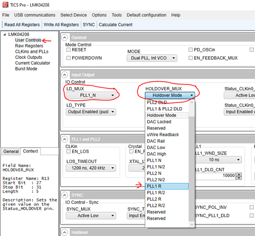

    Assuming none of that is the problem, my usual next step is to switch the I/Os to show the PLL1 R and N signals, and inspect with an oscilloscope. The controls for switching the I/O signals are LD_MUX and HOLDOVER_MUX located in the "User Controls" page under the "Input Output" group. Inspecting the PLL phase detector inputs could identify issues with signal not being received:
    • No R signal - maybe CLKin_Select_MODE is not selecting the correct input?
    • Erratic or unstable R signal - potential signal integrity problem
    • No N signal - check PD_OSCin=0, confirm VCXO is powered
    • Erratic or unstable N signal - potential signal integrity problem
    • Incorrect but stable frequency of N - check charge pump polarity is correct, check charge pump is active and not tri-stated, ensure loop filter is stable, ensure CPout1 voltage = VTUNE voltage for the VCXO
    Derek Payne

    I don't think I explained this clearly: you can actually set the Status_LD and the Holdover_LD pins to display signals other than the lock detect status or the holdover status. Some of the signals you can route out of the device are buffered copies of the signals at the PLL1 R/N divider outputs, or in other words the inputs to the PLL phase detector. Routing out the divider outputs, i.e. the phase detector inputs, can help to diagnose some of the lock issues you might be seeing. I included an image below to clarify how to configure the Status_LD and the Holdover_LD pins:

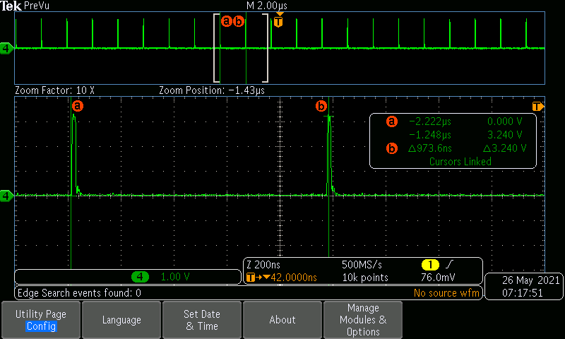

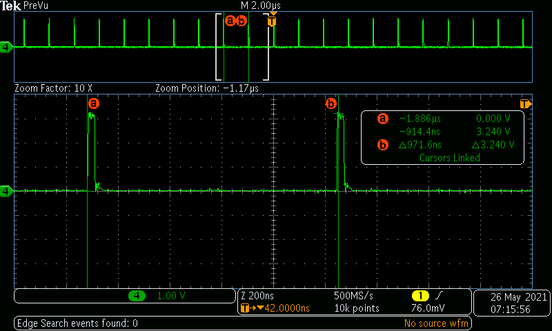

    With Freq Ref 38.4 MHz on CLKin1, we are not observing LD. (also there is no N signal observed (LD_MUX = PLL1 N))
  • Syahriza,
    It seems like the VCXO signal is not getting to OSCin, or else the OSCin buffer is routed in some strange way that's preventing the N-divider from toggling. Can you save your TICS Pro profile and upload it so I can review?
    Derek Payne
  • Found out that the VCXO was broken. Replaced the broken VCXO and now we could observe both N and R signals, but there is still no LD light. Btw, how can we upload files into this ticket? .

  • Here are the changes implemented:
    1. Replaced 122.88MHz VCX0 with  Crystek CVHD-950-76.800
    2. Replaced the following:
    1. C1_VCXO à 18 nF
    2. C2_VCXO à 820 nF
    3. R2_VCXO à 33kOhm
    3. C38 moved to populate C40
    4/ converted R17/C12/R12 to a 6dB pad à (R17=151Ω, C12=37.3Ω, R12=151Ω)
    After all the changes above, there is no LD signal observed ( Ref freq: 38.4MHz). Please take a look the observed N and R signals, and config file  in the previous comments.
    So not sure what the issue here. any comments? .

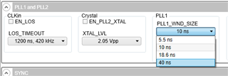

    With this configuration, are you seeing the VTUNE voltage at the VCXO pin close to 1.65V? It may be that the PLL is locked, but the lock detect window is set too tight. If you see a VTUNE voltage close to 1.65V, you could try setting the PLL1 window a little more relaxed at 40ns:
    If the VTUNE is still off in the weeds, next step can you try putting the charge pump output current to 1.6mA for debug? I see you have 0.1mA set, and I'm wondering if there's some VCXO input impedance or leakage issues that are impacting the current... 0.1mA is not that much current, so it sometimes isn't enough drive strength. Another possibility is the reduced 10Hz loop bandwidth isn't tracking some other noise source out e.g. 60Hz line noise from some system supply. I checked PLLatinum Sim and PLL1 should still be stable with the higher charge pump current.

     Changed PLL1 window to 40 ns, also changed charge pump current to 1.6mA. There is no change in Vtune or LD

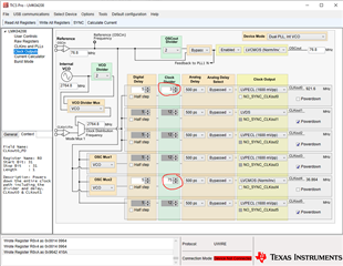

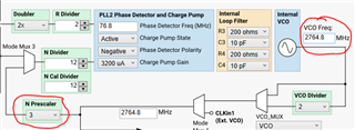

    The other issue we are seeing is the  CLock4 out is not accurate, With the current setting (attached)38p4MHz_RefWith_VCXO_76.8_0526.tcs the output of ClockOut4 should be at 76.8MHz,what being measured is at 105.98 MHz
  • Hi Syahriza,
    Apologies for the delay, E2E decided to hide my "reply" buttons...
    I see that the VCO is configured for 1843.2MHz, but you are using internal VCO. The VCO frequency range on LMK04208 is 2750MHz to 3072MHz. Did you perhaps mean to set the N-prescaler to 3, and the clock output dividers 50% higher?
    Also, in the user controls, I see you have PLL2_FAST_PDF=1. You should set this to 0 for a phase detector frequency <= 100MHz.
