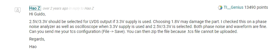

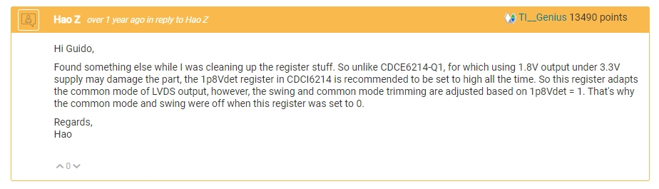

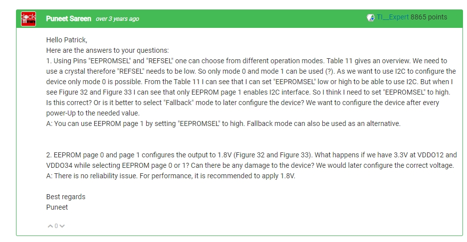

Prior to be more specific to the problem I want to have a clarification on the chX_1p8vdet setting. Some time ago I asked E2E if there is a risk of device damage when selecting EEPROM page 1 (with chX_1p8vdet set to 1) while having VDDIO12 and VDDIO34 at 3.3V. The answer was:
On an other E2E thread I can see that:
Or that:
Can someone from TI please clarify the situation and tell me what exactly the chX_1p8vdet setting does. If there is a potential risk of a device damage it would be very helpful if this topic is described in more detail in the datasheet.

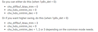

    Possible reason for the lower VOD: 1p8v_det bit is set to 0, and common mode is set to too high. High common mode and high bias current will cause some trouble.
    So you can either do this (when 1p8v_det = 0):
    • chx_diffbuf_ibias_trim = 0
    • chx_lvds_cmtrim_inc = 0
    • chx_lvds_cmtrim_dec = 0
    Or if you want higher swing, do this (when 1p8v_det = 0)
    • chx_diffbuf_ibias_trim = 3
    • chx_lvds_cmtrim_dec = 1, 2 or 3 depending on the common mode needs.
    The cmtrim_inc register increments the common mode. The cmtrim_dec register decrements the common mode.
    When 1p8v_det = 1 this problem should never happen.

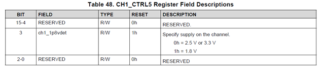

    In the datasheet I can read the following:
    So as VDDIO12 and VDDIO34 is 3.3V in our case, why should I set ch1_1p8vdet to 1h (1.8V)?
    You wrote in one thread that choosing 1.8V may damage the part:
    Maybe you can clarify the "Damage" statement for chx_1p8vdet setting while using 3.3V on VDDIO12 and VDDIO34.

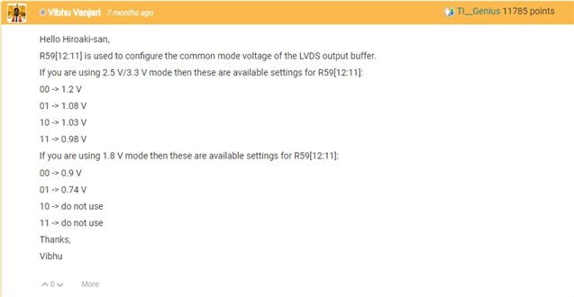

    In the datasheet I can also read that when DC coupled output common mode voltage VCM is 1.2V (@3.3V) if chx_lvds_cmtrim_inc=2. From an other thread I read:
    So here common mode voltage is 1.2V when the chx_lvds_cmtrim_inc value is 0. But maybe just chx_lvds_cmtrim_inc and chx_lvds_cmtrim_dec was twisted. That is very confusing. Default value for both chx_lvds_cmtrim_inc and chx_lvds_cmtrim_dec is 0. Any feedback on this is also highly appreciated.

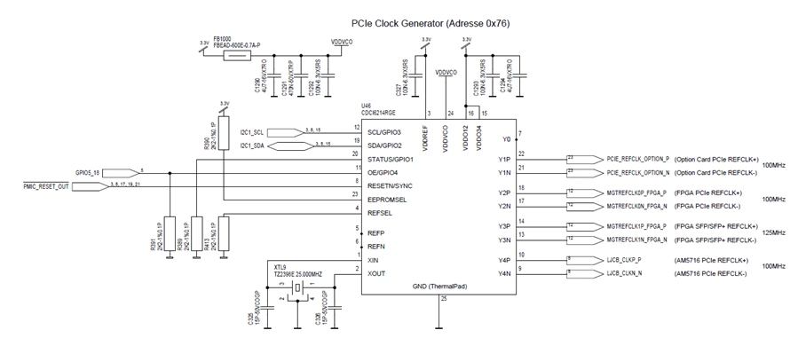

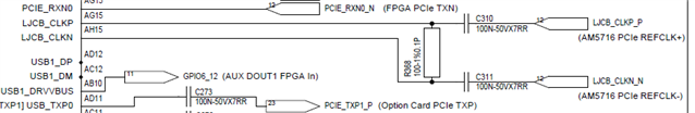

    Attached are the register settings of the CDCI6214. Also attached is the schematic of the CDCI6214 and the schematic of the AM5716 part where we use one of the clocks.

    Further analysis show that when I measure the clock at C310 on the CDCI6214 side with an oscilloscope I can see that the clock is slowly fading away from normal level (approx. 330mVpp) to around 100mVpp. If I measure the clock at C310 at the AM5716 side the clock is stable at approx. 330mVpp. AM5716 is not running because it is held in Boundary scan mode.
    Patrick
  • Hi Patrick,
    You can find the explanation attached: CDCI6214_debug_general.pdf

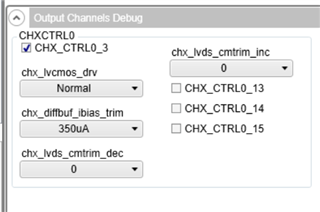

    In Ticpsro, change these settings:
    To below:
    However, I don't know why clock swing is different on two sides of the capacitor (this is theoretically impossible). You can directly measure the clock on the two pads of the capacitor and go from there.
    Hao
  • Hi Hao,
    Thanks for the information.
    The strange thing is that if I measure on both sides of the capacitor with two probes the amplitude is ok as well (also with the settings I already have).

  • Hi Patrick,
    I just received the confirmation from designer. When bit chx_1p8vdet is set to 1, the common mode voltage will be reduced to a very low value. If that's acceptable, then there's no issue. Setting it to 1 with VDDO = 3.3V won't damage the device.
    Hao
  • Hi Hao,
    That is good news. Thanks for the clear statement. So my first question is answered and I will close the thread although we still have this strange measurement effect.
