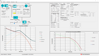

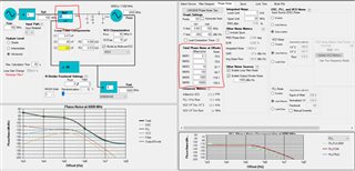

We have a question about PLLatinum Sim. Nowadays, we try to choose best synthesizer for our new project, so we make some simulation with PLLatinum Sim and take measurement from LMX2820EVM.
In PLLatinum Sim when I click LMX2820 Phase Noise Tips, first tip say that ‘Phase Noise is better for high charge pump modes’. But our simulation results do not support this explanation.
Also in datasheet Figure 6.1, we have three questions:
1-) How the charge pump current was set during this measurement.
2-) Is the loop filter configuration same with LMX2820EVM.
3-) Can you share with us reference oscillator and reference oscillator phase noise value in figure 6.1 (1k,10k,100k,1M)
  • Hi Onur,
    I suppose it would be more accurate to say "PLL noise is better for higher charge pump current modes." However, loop bandwidth also changes, with higher charge pump current leading to higher bandwidth (all other things being equal). It's possible that, with increased charge pump gain, the bandwidth change increases the noise at higher offsets with the increased bandwidth.
    The plot below demonstrates this by taking a comparison trace of the PLL noise (dotted red) with 2.8mA charge pump gain. Compare this against the solid red trace labeled PLL, and you'll see that increasing the charge pump gain has decreased the 1/f noise and brought the PLL FOM down.

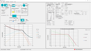

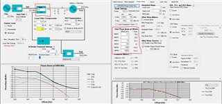

    Your screenshots show that the loop bandwidth has not been made equal. In the first case, your loop bandwidth is 10s of kHz; in the second case, your loop bandwidth is 100s of kHz. If you redesign the loop filter for the same bandwidth with different charge pump gain, you may find results are different.
    In the next screenshot, I have reduced the loop bandwidth of the 15.4mA charge pump case to the same as the 2.8mA case - about 97kHz. The comparison trace (dotted red) is still the 2.8mA charge pump case from earlier, with default EVM loop filter values. But now we have changed the loop filter values in the 15.4mA case to match the loop bandwidth more closely. It becomes very clear that the PLL phase noise is better with higher charge pump current. The overall noise is, however, greatly increased, because the loop filter does not attenuate as much VCO noise.
    Now, more importantly: your oscillator input (green trace) is completely dominating the total noise. There's hardly any reason to play with PLL parameters when the reference noise dominates the application. I'll upload our 100MHz Wenzel oscillator used for evaluation below.
