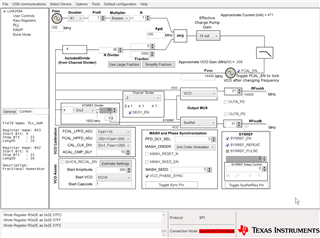

I am trying to get SysRef out from OutB_Mux=SysRef mode, but no output from RFoutB pin.
Since I attached PLL screen and register file, what could be wrong to output RFoutB by RefSys input signal with minimum delay?

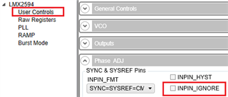

Hi Young,
Did you uncheck INPIN_IGNORE?
To debug, uncheck SYSREF_REPEAT to put it in SYSREF master mode, pull the SysRefReq pin HIGH, you should get continuous 75MHz clock from RFoutB.
