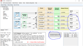

We would like to generate 24.576MHz from 25MHz reference clock.
Our register settings is shown in "Regsters_settings.txt".
We send extract from datasheet too,  which we referred to.
Could you check our register settings and give us some advise?
Sesumi
Divider_configration_reference.xlsx

    {CDCE6214_R0, 0x00},    /* 0x0000 */
    {CDCE6214_R2, 0x00},    /* 0x0000 */
    {CDCE6214_R3, 0x00},    /* 0x0000 */
    {CDCE6214_R4, 0x00},    /* 0x0000 */
    {CDCE6214_R5, 0x08},    /* 0x0008 */
    {CDCE6214_R24, 0x0718},   /* 0x0718 */
    {CDCE6214_R25, 0x0400}, /* 0x0400 IP_BYP_OUT0_EN = 1, IP_REF_TI_OUT1_EN = 0 */
    {CDCE6214_R30, 0x62},     /* 0x0030 N = 98 */
    {CDCE6214_R31, 0x62FE},   /* 0x0000 Num = 5071614 ���� */
    {CDCE6214_R32, 0x4D},     /* 0x0000 Num = 5071614 ��� */
    {CDCE6214_R33, 0x8FBE},   /* 0x0000 Den = 16682942 ���� */
    {CDCE6214_R34, 0xFE},     /* 0x0000 Den = 16682942 ��� */
    {CDCE6214_R41, 0x00},   /* 0x0000 */
    {CDCE6214_R42, 0x00},   /* 0x0002 */
    {CDCE6214_R43, 0x00},   /* 0x0051 */
    {CDCE6214_R47, 0x00},   /* 0x0a00 */
    {CDCE6214_R53, 0x00},   /* 0x0069 */
    {CDCE6214_R56, 0x19},   /* 0x0006 Divider 25 */
    {CDCE6214_R57, 0x4000}, /* 0x4000 */
    {CDCE6214_R59, 0x2008},   /* 0x0008 Enables OUT1P LVCMOS Buffer */
    {CDCE6214_R60, 0x08},   /* 0x0008 */
    {CDCE6214_R62, 0x06},   /* 0x0006 */
    {CDCE6214_R63, 0x00},   /* 0x2000 */
    {CDCE6214_R65, 0x00},   /* 0x0008 */
    {CDCE6214_R66, 0x00},   /* 0x0000 */
    {CDCE6214_R67, 0x06},   /* 0x0006 */
    {CDCE6214_R68, 0x00},   /* 0x2000 */
    {CDCE6214_R70, 0x00},   /* 0x0008 */
    {CDCE6214_R71, 0x00},   /* 0x0000 */
    {CDCE6214_R72, 0x06},   /* 0x0006 */
    {CDCE6214_R73, 0x00},   /* 0x2000 */
    {CDCE6214_R75, 0x00},   /* 0x0008 */
    {CDCE6214_R76, 0x00},   /* 0x0008 */
    {CDCE6214_R77, 0x00},   /* 0x0000 */
    {CDCE6214_R78, 0x1000}, /* 0x1000 */
    {CDCE6214_R79, 0x08},   /* 0x0008 */
