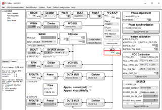

  • Hi Yao Hua,
    Here is the test procedure:
    1. Open TICS Pro and select EVM default mode configuration
    2. In User Controls page, check all Double Buffer bits
    3. In PLL page, uncheck DBLR_CAL_EN in Instant calibration box
    4. Vcc power up the EVM
    5. Press Ctrl+L to program the EVM to lock to 6GHz
    6. Set INSTCAL_EN = 1 in Instant calibration box
    7. Type 5650 and then Enter in the VCO box (PLL_NUM, PLL_N and INSTCAL_PLL_NUM will be programmed automatically)
    8. Uncheck FCAL_EN in the VCO calibration box
    9. Check FCAL_EN
    10. Uncheck FCAL_EN and wait for a while (VCO will lock to 5650 MHz)
    11. Change VCO frequency, for example, type 5800 and then Enter in the VCO box (PLL_NUM, PLL_N and INSTCAL_PLL_NUM will be programmed automatically)
    12. Click Calibrate VCO button (this will write R0 once, VCO will lock to 5800 MHz)
    13. Change VCO frequency to, for example, 6200 MHz
    14. Click Calibrate VCO button (this will write R0 once, VCO will lock to 6200 MHz)
    Please note, the written SDA will be shifted to the internal register at the last (LSB) SCK rising edge.
    TICS Pro is running at around 125kHz, The delay between the last SCK rising edge and CSB is one SCK cycle. That is, the delay is around 8µs. If you use CSB as the trigger signal to the test equipment, be caution to this 8µs error.
    Hope this helps.

  • Hi Yao Hua,
    After instant calibration is done, the same frequency switching mechanism will apply to any VCO frequency and any VCO core.
