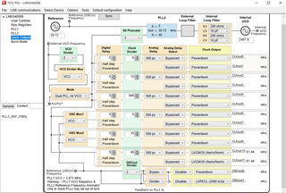

My customer set up the LMK04806 to output 61.44MHz on CLKout 10 and CLKout 11 as shown below.
The CLKout11 outputs a normal clock signal, but the CLKout10 has no output.
Please review whether there is a problem with the attached register setting.

    I don't see anything wrong with the registers. Can you have the customer check a few things:
    • Can they get an output out of other formats from CLKOUT10? For instance, can they get LVDS from CLKOUT10?
    • If they probe the pins, rather than the trace or the output connector or some other spot, do they see output? Checking for soldering issues.

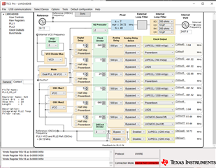

    2. The customer set up the LMK04806 as shown below.
    The clock signals of CLKout6, CLKout7 and CLKout8 are output differently from the settings in the GUI.
       - CLKout6 and CLKout7 : Set value - 491.52MHz / Output - 192MHz
        - CLKout9 : Set value - 3.84MHz / Output - 19.3MHz
    Is the above setting not possible?

  • JH,

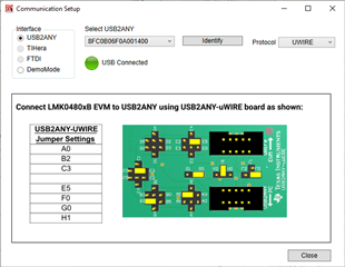

    In the image above, it shows that the connection mode for TICS Pro is "Device Not Connected". Are you using this as an example for my benefit? Or is this what the customer is providing you? This sounds like a communication error, as I can't see another way the dividers could be incorrect with one value high and the other value low. Can you please ensure that the customer has the USB2ANY connected through the UWIRE bridge, with the jumpers connected as shown?
    Derek Payne
  • Hi Derek,
    The TICS Pro image was received from the customer. They does not have LMK04806EVM.
    They uses TICS Pro to create the register values and test the LMK04806 operation on the custom board.

  • JH,
    Understood. The UWIRE interface is different from a standard SPI signal, so that would be my next guess for reasons why things would be so wildly off.
    I know that there are some special conditions for programming dividers when the value of the divide is > 25, see section 8.5.1. Is this being done?
    Are they applying a signal to the OSCin port during register programming?
    I'm also going to reach out internally to see if someone else on the clocking team with more experience with LMK04806 has ever seen something like this.
