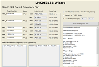

Hi Team,
During a HT test, customer found LMK05318B has much worse packet loss problem than RT,
HT test condition is: while CHAMBER 65°C, LMK05318B surface temp 88°C

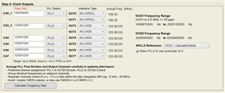

In the end, I found customer uses LMK05318 register setting to program into LMK05318B, customer thought they are bom to bom device.
After helping re-generate register file in TICS - LMK-05318B, packet loss problem resolved.
Customer would like to understand what could be the root cause. (I was guessing very small output freq diffrence and getting worse at HT?)
Thanks for explain in detail, customer needs it, thanks.
Andrew

  • Andy,
    Can you provide both the original (LMK05318) and the corrected file, and clearly identify which one is which? Without both files, it will be difficult to determine a root cause.
    Derek Payne
  • Hi Derek,
    Thanks.
    Customer gave me this file below only.

  • Andy,
    These two files are almost completely different for both the DPLL programming and the APLL programming. Noticeably, the DPLLs in the file you provided are disabled - no reference input is being used. Meanwhile, the LMK05318 file appears to be using the DPLL. I don't understand what the intention was for the original registers, because the new registers appear to be using the device completely differently.
    What was this device doing beforehand? It is definitely not doing the same thing in the new register configuration.
    Derek Payne
  • Hi Derek,
    The register setting that used on LMK05318 was generated by another FAE who quitted, so I couldn't get tcs file to compare, thanks for checking.
    Customer is not using DPLL path, only using XO = 24.576MHz path.
    Could you please help to check if they are same output freq for each CH?
    From screen shot, I think they are the same.
    Customer would like to know if copying LMK05318 non-B register setting directly into LMK05318B, what problem do you foresee?
    Thanks.
    [LMK05318]
    [LMK05318B]
  • Hi Andrew,
    LMK05318 register settings can be directly applied to LMK05318B chip, but not vice versa. A few debugging steps:
    1. Check the status registers. The instructions can be found in the last page of LMK05318B wizard.
    2. If everything's locked, measure the output frequency and see if the frequency was mis-caculated.
    Hao
  • Hi Hao and Derek,
    Thanks for feedback and time looking into this.
    Currently we are locked at home and prohibited from visiting customer, so does customer to see us.
    I will do the status check and output freq check with customer when available.
    Just one quick question, if we use LMK05318 register settings directly applied to LMK05318B chip (to output 156.25M & 125M), there is 'chance' output freq could be slightly different on B-ver, this root cause finding direction should be a good start, correct?. Thanks.
    Andrew
  • Hi Andrew,
    If you directly load the LMK05318 register settings into a LMK05318B chip, you should get exactly the same behavior. There will NOT be any frequency difference because the B version is backward compatible by design. It has more features and improvements but it can accept the non-B software without any change.
    Hao
