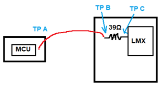

  • Noel/Derek
    I probed at the Clock test point pin and am seeing that my clock is still being attenuated/killed, despite me replacing the 12kΩ resistor with a 39.3Ω resistor
    The signal coming out of my controller is clean and the drive is relatively strong - any idea what might be causing this?
  • Hi Dylan,
    Did you mean you've got good waveform at TP A but bad waveform at TP C? How does the signal look like at TP B?
  • TPA is good, TP C looks like the old attenuated signal, I will probe at TP B to look and see
    I am using the SCK_TP on the Eval board, I ran it without an input clock, just the 3.3V powering the LMX and saw the 50MHz clock (with a better scope albeit), I will try the full setup again with a different oscilloscope
  • The internal impedance of the eval board pins (Arty S7) was interfering with my signal drive when coupled with the 39Ω resistor, effectively killing the high frequency signal. Moving to 0Ω resistor pins while keeping the 39Ω resistors on the LMX2595 board fixed the clock, although now I have the problem of the clock swing being too big (6.7V from a LVCMOS33 driver somehow)
    Should I increase the 33Ω resistor to 50Ω to help tame this signal?
  • Hi Dylan,
    Did you mean the voltage swing at TP B is now 6.7V? If your MCU is 3.3V operated, you should not get 6.7V from it.
  • TPA, B, and C is 6.7V. I did some calculations and it appears that it could be due to my reflection coefficient (1.8x)
    Additionally, the SDI line at those test points is killed, it doesn't seem to be effectively clocking out that data.
    I am going to replace the 33Ω resistors with 0Ω resistors and communicate via the 200Ω resistor pins on the Arty - I think this will fix my problem of attenuation
  • Hi Noel,
    Replacing the 33Ω with 0Ω resistors and increasing my FPGA drive strength fixed the reflection/attenuation problems I was having
    I can now write to the FS - thank you for your help
