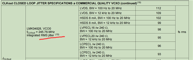

one of our customers would like to know whether the RMS Jitter for LMK04832 is Jee(Edge-to-Edge Jitter)'s or Jcc(Cycle-to-Cycle Jitter)'s? Could you by any chance confirm it for me ?

This is the frequency domain integrated jitter from phase noise plot.
Details can be found in the following training video.
