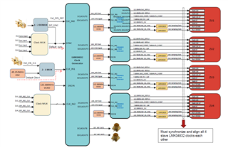

i). we are using LMK04832  CLK synthesizer in our design for RFSoC FPGA  for multi clock synchronization. We have one Master LMK04832 driving reference signals to Clockin1 and sync/sysref to clockin0 for 4 slave LMK04832. the architecture is added below.
The master LMK04832 default has 49.152MHz input to clockin1, 122.880 MHz VCXO input to OSCin and sync/sysref signal input to sync pin of LMK. As in architecture, the Master LMK outputs device and sysref clock pair is connected to clockin1 and clockin0 of slave LMKs.  The slave LMK  required output frequencies  are as:
DCLKOUT0 : 245.76MHz( input to first LMX2820)
SDCLKOUT1: sync to first LMX2820
DCLKOUT4: 245.76MHz( input to second LMX2820)
SDCLKOUT5: sync to second LMX2820
SDCLKOUT3: 7.68MHz AMS_SYSREF
DCLKOUT6:  122.88Mhz DAC_REFCLK
SDCLKOUT7:  7.68Mhz DDR_PLY_CAP
DCLKOUT8: 122.88MHz PL_CLK
SDCLKOUT9: 7.68MHz PL_SYSREF
DCLKOUT12: 122.88Mhz ADC_REFCLK
all the 4 slave LMK output clocks need to be synchronized and aligned for Multi clock synchronization (also multi-FPGA synchronization).
How should be a Master LMK04832 device and sysref outputs need to be configured if the slave LMKs are to be used in dual loop zero delay nested mode such that the Multi clock synchronization is achieved.

  • Hi Kiran,
    Please follow the below link to get more understanding on Multi-clocks synchronization.
    https://www.ti.com/lit/an/snaa294/snaa294.pdf
    For a single LMK device (master) in Nested Zero-Delay Dual-Loop Mode (ZDM) require to satisfy few rules to provide the deterministic phase between input and output signals.
    It needs to follow both the rules of ZDM
    • Input Clock = SYSREF
    • GCD(outputs) = SYSREF, all device clocks can share an edge with the SYSREF edge
    Slave LMK04832 is used in clock distribution mode. The Sysref_mux is set to Normal SYNC. here i understood the Clockin0 is re-clocked by Clockin1.
    As per your latest architecture, secondary LMK (slave) can be distribute SYSREF from CLKin0 re-clocked by CLKin1 but SYSREF divider should meet it's minimum divider value (8). currently it is 5 (10.24/2.048).
    My other question is can i use master SYSREF as pulser and use these pulses as sync to slave LMKs and use slave LMK in continuous SYSREF or the above configurations are OK. Our requirement is to have continuous SYSREF at Slave LMKs outputs.
    Yes, you can make secondary LMK SYSREF in continuous mode by resetting the SYSREF divider from primary LMK as sync (pulse). As mentioned above, your frequencies should be adjusted so you can use minimum SYSREF divider value 8.
