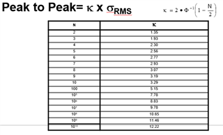

  • Hi Mita,
    From RMS to peak-to-peak you can refer to below:
    I'm not aware of any direct conversion from 12k-20M jitter to period/cycle-to-cycle jitter, because the former is measured in phase domain whereas the latter is measured in time domain. We typically avoid measuring the noise performance in time domain because the result can be inaccurate. 12k-20MHz integrated jitter is a more common spec.
    Hao
