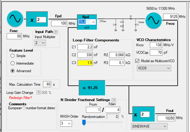

We are using the LMX2820 to generate a frequency of around 18250 GHz, w hich the following configuration:
Layout and components are the same that TI used in the evaluation board.

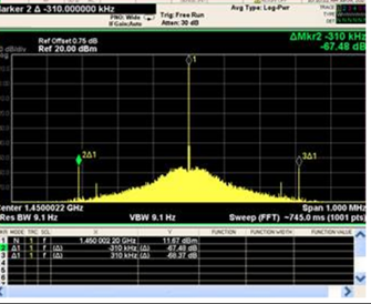

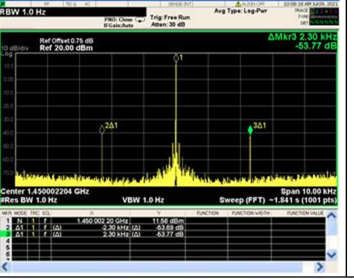

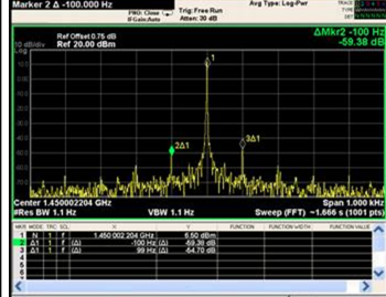

Spurs are more or less the same that the SW calculates, with the expeption of low frequency spurs (1khz or 2khz around LO):
We have tested three different references (OCXO, Keysight signal generator, PNAx generating a tone).
We have tested different power supplies ( DC board, Keysight power supply R&S Power supply.
We have switched off the controller.
And anything changes... Any help?
Thanks in advance,
PS: 100 hz could be lamps frequency, we are more worried about the khz spurs.

    For the attached plots (1.45GHz, with 50MHz reference), your device is operating in integer mode and it doesn't seems to be generates any spurs at few KHz range.
    I did the quick check on the LMX2820EVM setup and doesn't shows any spurs at these range.
    This indicates to me that either there is something going on with your reference introducing the spurs, or else you have another noise source mixing into your device (is USB2ANY connected?). In some other cases, we have seen some spurs from USB2ANY / reference etc.. If reference already checked, would be suggested to remove the USB2ANY after programming and see the performance.

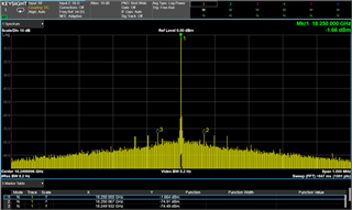

  • Hi Aizkibel,
    Thanks for your patience.

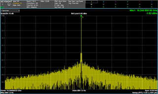

    I have the check on my LMX2820EVM for the requested frequency performance and it looks pretty clean at 18.25GHz.
    You may see the noise floor up, that could be my reference is not so clean, but we don't have any spurs at kHz offset. See below:
    You can have a look on your setup, while isolating each section and can debug the spurs.
