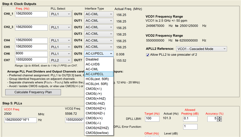

My customer would like to know how to configure CH6 as 1.8V CMOS single-end output?
The VDDO is 3.3V in SCH.

All CMOS options are single ended outputs. The question is what they would like to have happen to the n side of the channel, if they're using p-side, and alternatively they can choose to just use the n-side.
CMOS support is only 1.8V on LMK05318 irrelevant of whether Vddo = 3.3 or Vddo = 1.8.
