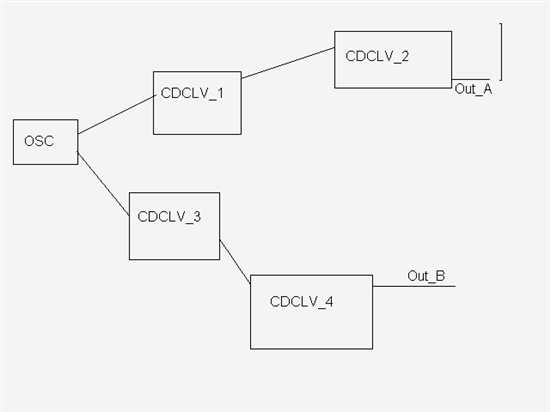

    I am building a clock distribution tree with this family of parts and I want to calculate the worst case skew between any two end points.
    Is the calculation as follows:  Skew (max) A-B =  Tsk,pp (dev_2) +  Tsk,pp (dev_1) +  Tsk,pp (dev_3) +  Tsk,pp (dev_4)
    Basically the worst case addition of the Part-to-Part skews?  Do I also need to take into account the Tsk,p Pulse Skew?  Will this duty cycle distortion look like additional skew between the endpoints?
    Hi Alfred,
    Yes, you are right. Addition of part-to-part skew  along with additive jitter will provide you worst case skew.  You don't need consider pulse skew here.
    We have only typical additive rms jitter in the datasheet. You need here max p-p jitter. You can assume 5 p-p jitter for each buffer.
