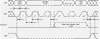

My customer is working on a design where FPGA is interfacing to the LMX2820 and is am having trouble finding any information on the SPI interface.

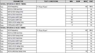

The data sheet contains the timing parameters, but not a timing diagram or even a description of what the protocol is. Specifically, he needs to know what position / how many address bits, Read / Write Bit, and Data bits in a SPI transaction.

    SPI is same as LMX2594, here is the details.
    Register structure
    • The LMX2820 is programmed using 24-bit shift registers.
    • The shift register consists of a R/W bit (MSB), followed by a 7-bit address field and a 16-bit data field. For the R/W bit, 0 is for write, and 1 is for read.
    • Serial data is shifted MSB first into the shift register.
    Programming notes
    • To write registers:
    –The R/W bit must be set to 0.
    –The data on SDI pin is clocked into the shift register upon the rising edge of the clocks on SCK pin. On the rising edge of the 24th clock cycle, the data is transferred from the data field into the selected register bank.
    –The CS# pin may be held high after programming, which causes the LMX2820 to ignore clock pulses.
    –If the SCK and SDI lines are toggled while the VCO is in lock, as is sometimes the case when these lines are shared between devices, the phase noise may be degraded during the time of this programming.
    • To read back registers:
    –The R/W bit must be set to 1.
    –The data field contents on the SDI line are ignored.
    –The read back data on MUXOUT pin is clocked out starting from the falling edge of the 8th clock cycle.
