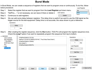

Would you mind if we ask TICSPRO-SW?
There is "Burst mode" on TICSPRO-SW.
What is this mode used for?
Is it impossible to program sequences of register programming or pin control?
For example, is it impossible to program sequences of register, R0->R2->R4,,,,,?
