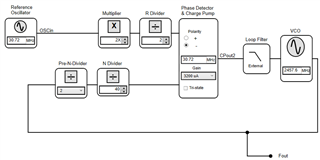

My customer is using the LMK04806 with the PLL2 setup below and the PLL2 is locked normally.
However, it is said that changing the N divider combination from 2/40 to 4/20, the PLL2 is unlocked.
Are there any rules to follow for PLL2 N divider combinations?
Or is there a problem with the customer's settings?
Thank you.
JH
  • Hi JH,
    During the VCO frequency calibration, it would take PLL2_N_CAL value for calibration and PLL2_N_CAL value should be same as PLL2_N.
    So when they are changing the PLL2_N value from 40 --> 20, they need to change the PLL2_N_CAL value also to 20 (R29 register).
