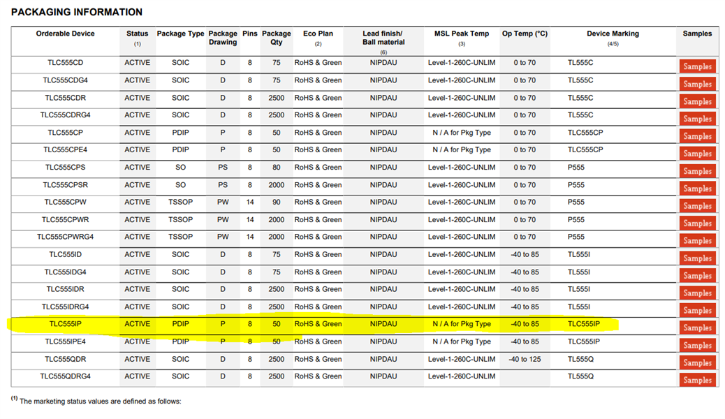

Our customer have a few parts of TLC555IP-P2 and he wanted to know the difference between TLC555IP and TLC555IP-P2.
Can they be used interchangeably?

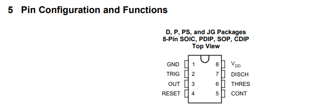

The TLC555IP is the PDIP version. I'm not able to find TLC555IP-P2 in the PDS. Do you know where the customer has seen -P2 listed? The pinouts are the same for the devices listed in the product datasheet and can be used interchangeably. I would need to look into the -P2. If you have any more information to help me locate this it would be helpful. I will ask around as well to see if anyone knows.
Hello Chris,
Customer is from Rochester, but when I checked using internal tools from TI, I am seeing the TLC555IP-P2 as active but non_distry.
