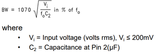

My customer is asking the detection bandwidth for following condition. Could you kindly help?
・Input voltage : DC offset voltage=2V, amplitude=±200mV.
・detection frequency(fo)=1.8kHz
・Loop Filter cap(C2)=0.1uF
・output filter cap(C3)=0.47uF
First, is it correct to calculate Vrms by Vrms = amplitude / √2 ?
And can you share the calculation and result for detection bandwidth?
I see there are two formula depends on Vrms> 200mV or < 200mV, but I'm not sure which should I use in this case.
