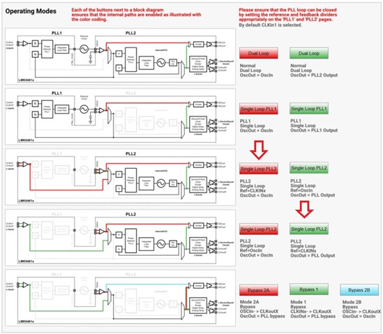

We are evaluating the LMK04610 but I am having issues with the evaluation module.  I’m using a 100 MHz source, and trying to get a 100 MHz output bypassing the VCXO.
I’m selecting either of these 2 modes:
When I look at the PLL2 Reference clock using the mux on the status pin, I see it.  But, I am not getting a clock out.
There is a bug when using the Frequency Planer where is doesn’t write the dividers to PLL1.  I got it to work by changing them using the PLL1 control screen.
What can I provide to help you help me?
Adam
  • Hi Adam,
    Usually when there are no other outputs on LMK04610 it can be because the VCO-to-output buffers are disabled, the outputs are not enabled, the output formats are not specified, or the outputs are being held in a divider reset state due to a SYNC pulse.
    • Check PLL2_EN_BUF_CLK_BOTTOM and PLL2_EN_BUF_CLK_TOP (should be enabled)
    • Check OUTCHx_LDO_MASK settings (should be disabled for output enabled)
    • Check OUTCHx_DRIV_MODE is set to a value other than powerdown
    • Confirm SYNC state is not high based on SYNC pin settings and EN_SYNC_PIN_FUNC, INV_SYNC_INPUT_SYNC_CLK, SYNC_PIN_FUNC, and GLOBAL_SYNC settings
    • Confirm outputs are not set as SYSREF with some non-continuous pulse count
    If there still has a problem after making these adjustments, please provide the .tcs file (preferred) or the hex registers (if .tcs file is not available) with settings for review.
