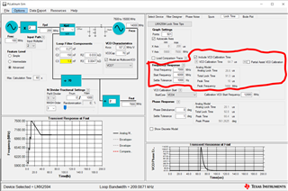

  • Is there a way to estimate the analog lock time?  If I can obtain an estimate, then I can challenge the requirement
  • Hi Kevin,
    For estimating the lock time based on loop filter BW, operating frequency, tolerance and other controlled parameters, you can use the PLLatinum Sim tool. Which would help to provide the calculated over all lock time and analog lock time.
    Ex. shown below:
    Ajeet Pal
