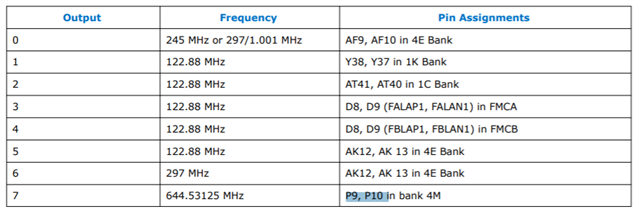

We have purchased a Stratix 10 Eval board and want to get default clocks as mentioned in the table
Please could you help me in programing the default parameters as shown the above table

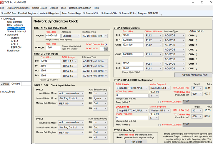

Hi Neeraj,
You can edit Steps 1-6 in the TICS-PRO GUI to determine the correct register settings.
