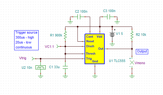

Question about RA and C value on datasheet page 15, figure-9.
Is there recommend "maximum" range for RA and C value?
For example, are RA: 700kΩ~900kΩ and C: 33μF (Electrolytic capacitor) value no problem?
※VDD: 10V
If there possibility to occur any problem by large tw, RA, C, please let me know.
