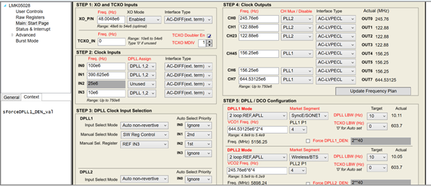

I am working on the Intel S10 SX SoC Dev Kit . LMK05028 chip is mounted on the board. The TCX0_IN is not driven by any clock. The IN3 is driven by 10Mhz from GPS. My requirement is that OUT7[644.53125Mhz], OUT5[390.625Mhz] should be generated from GPS 10Mhz as reference .The OUT5 and OUT7 are connected to FPGA. The OUT7 clock is the reference clock for the MAC inside FPGA.
DPLL1 and DPLL2 priority of clock is same. 10Mhz[IN3] has highest priority.
I have configured TISC Pro with below configuration. We are not getting required output that is 644.53125Mhz instead we are getting 644.46Mhz. And OUT5 if I configure 390.625Mhz actual frequency column in GUI become zero. Could you please guide me to get the OUT7 and OUT5 with proper output and frequency in sync with GPS 10Mhz.

  • Hello Neeraj,
    The reason OUT5's frequency goes to zero is because you are attempting to have a 390.625 MHz clock and 644.53125 MHz clock come from the same PLL. Since there is no common multiple of the two frequencies, the 390.625 MHz gets set to 0. Please change your clock outputs to look like below:
    Please note I moved the 390.625 MHz clock to OUT0 because OUT[0:3] bank requires at least 1 clock from PLL2 for the DPLL calculations to occur.
    The reason OUT7's frequency is not locking to 644.53125 MHz is most likely due to the DPLL1 not locking. I have preformed the run script calculations for the DPLLs, so now the frequencies should be locking to their target values.

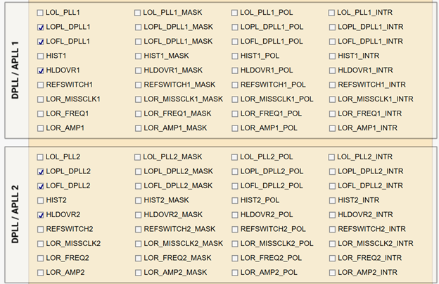

  • Hi Kia:
    Status of LOL_PLL1, LOPL_DPLL1, and LOFL_DPLL1 and HLDOVR1 are set.
  • Hello Neeraj,
    This means your DPLLs are not locking, thus leading to the inaccuracy in output frequency. Once you get the DPLL to lock then the outputs will be exactly 644.53125 MHz and 390.625 MHz.

  • Hi Kia:
    As you suggested i changed the interface type to HCSL and i am able to get lock of LOFL_DPLL1 and LOFL_DPLL2.
    Since Phase is not locked. DPLL1 and DPLL2 are still in Holdover mode.
    So when reading registers i am seeing LOPL_DPLL1,LOPL_DPLL1 and HLDOVR2 are set.

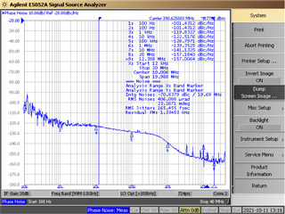

  • Hello Neeraj,
    I believe I have found the issue. It appears the device is having difficulties detecting your reference. To have the reference be detected and the DPLLs to lock properly, I disabled the frequency detect threshold for the inputs as shown below.
    Once I disabled these thresholds, I was able to get the DPLL to lock and have the device properly output your target frequencies.
    Here is the tcs file of the configuration I used to get proper output frequencies:
     6175.LMK_644_OUT7_390_OUT5_10Mhz_IN3_updated_by_TI.tcs
    Please load this file into your TICS Pro, then press soft-reset chip and then everything should be working properly.
    For your reference, here are the output frequencies I received with this configuration:
    Before using this method, ensure that your 10 MHz reference is stable and locked to 10 MHz.
