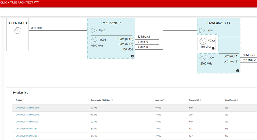

hi,
my customer wants to clock generator for configuration below.
  1. 80MHz *6 (for AFE5828 and FPGA)
  2. 320MHz *6(for TX7516 and FPGA)
  3. 2MHz *3(for AFE5828 CWD and FPGA)
  4. 32MHz *2(for AFE5828 CWD)
They think that LMK04228 may be suitable.
any concern? the reference clock is 2MHz?
do we have reference design?
