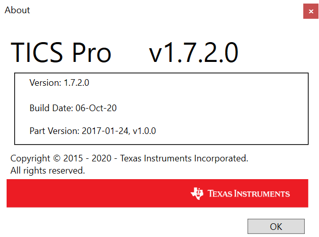

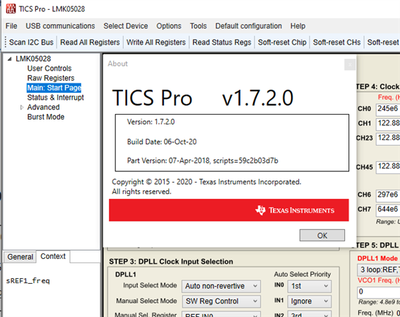

  • Hi Derek, programming did not work; customer did not further evaluate as he found a quick solution by using the older version but here are some observations:
    TICSPRO-SW Application software & framework | TI.com shows release date July 6th 2021
    while the TICS Pro tells under Help -> About: October 20th 2020
    This looks like something went wrong, do you agree?
    Thanks and Best Regards,
    Hans
  • Hans,
    TICS Pro executable version/build date and TICS Pro device profile version are different. For unimportant reasons, we are currently forced to release a new installer version with the same TICS Pro executable version and binary (1.7.2, built October 20, 2020) every time we make a minor tweak or bug fix to a device profile or release a new device on the software. The discrepancy you highlight is (frustratingly) things working as intended.
    It sounds like the customer solved their issue. Unless they have an interest in exploring the problem further, I'll mark the thread as resolved.
