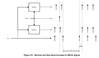

Hi, can you suggest a reference fosc part number for the following;

    If you were talking about splitting a reference clock into two, you may consider to use a clock buffer such as LMK00105.

  • Hi Siddharth,
    Crystal is a passive device which requires an oscillator to generate clock.
    VC708 is a crystal oscillator, it can generate clock when a proper power supply is applied to it.
    LMK00105 has built-in oscillator that accept 10MHz - 40MHz crystal. LMK00105 also support up to 200MHz clock. Your block diagram is correct.
