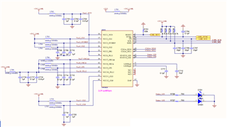

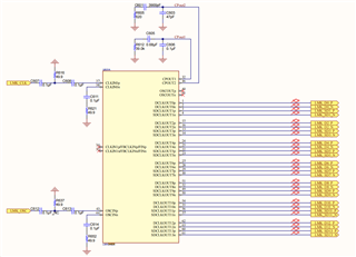

LMK04828: The output of Status_LD2 is high, which means that PLL2 has been locked, but the output clock can not be measured. Please give me guidance on what is wrong.
Part Number: LMK04828
1. The schematic diagram  is as follows:
2. The register configuration file generated by TICS Pro is as follows:

  • Hi Dongqiang,
    Here's what I observe:
    • You have SYNC pin pulled high, and SYNC_DIS0 cleared. Combined with your SYNC_MODE and SYSREF_MUX settings, you are asserting a divider reset at the divider for DCLKout0. Set the SYNC_DIS0 bit to 1 or pull the SYNC pin low to release the channel divider reset condition and star t the output clocks.
    • Since your divider value on DCLKout0 is an odd number (not even), I recommend setting DCLKout0_MUX to Divider+DCC+HS to enable the Duty Cycle Correction (DCC) circuit. This will force the divide-by-25 to have 50% duty cycle. Not required, but beneficial.
    • PLL2_N_CAL should match PLL2_N for this configuration. If PLL2_N_CAL differs from PLL2_N when the PLL2_N LSBs are written, the PLL2_N_CAL value will be substituted for VCO calibration; if the PLL2_N_CAL value does not lock the PLL, the VCO calibration will fail and it may prevent lock or cause loss of lock at some temperature.
