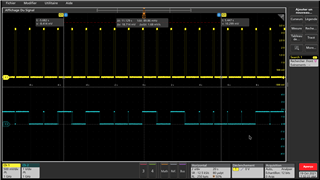

We are currently using LMK05028 to generate 122.88MHz in 3 loop mode with 20MHz TCXO and 48MHz XO from an 1Hz (GPS PPS).
We are facing issue to get the ref0 to validate.
I measured the PPS and the STAT0 output (with REF0 monitor div out div by 2). It's never stable, ref0 validation is unstable.
(PS: If i enable the 1-PPS Jitter threshold, ref0 never validate at all).

  • Hello Cyril,
    I presume this is on a board you made vs. the EVM.  Can you share the schematic?
    So it looks like your div-by-2 signal is producing more transitions than expected.  I'm wondering if there is some extra noise riding on the 1 Hz signal that is triggering more transitions than there should be.

    I found out the root cause, switching to 50% duty cycle on the PPS input solved the validation problem.
    The pll is now locked solid, just need some more work on frequency and phase lock threshold.
