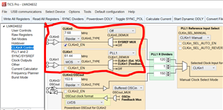

  • Hi Manasa,
    Your above description shows master LMK input frequency is 49.152MHz, whereas configuration file includes 61.44MHz at CLKin1 input. That could be reason of PLL1 lock issue. Also CLKin1_EN needs to be enable, which is giving the input at PLL1.

  • Hi Ajeet,
    We changed the settings and we are operating master LMK in Dual loop mode and slave lmk in  Dual loop Zero delay nested mode
    Master input frequency :61.44MHz
    Vcxo Frequency : 122.88MHz
    Master output Frequency : 7.68 MHz
    This master output frequency we are feeding to slaves .
    Loop filter values same as EVM.And in master LMK input we are using Single ended clock .Please make sure our Tcs file is correct or not.

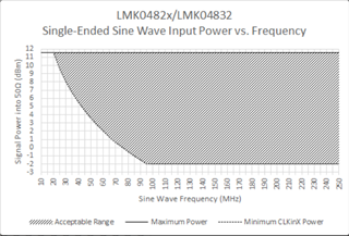

    Regarding the Slave LMK, as you are feeding the single ended input to this and it needs to satisfy the input slew rate and input pk-pk voltage requirements at 7.68MHz CLKin inputs.
    You can verify the input signal specs and that could be the reason of PLL unlock/blinking.
    You can try with the LVCMOS single ended output from Master LMK, which will have higher pk-pk output and should work fine with it.
    Below is the graph for minimum input level requirement for single ended sine wave inputs over frequency and it needs higher input level for lower input frequency.

  • Hi Manasa,
    It seems there were a mis-reporting, as Master LMK has single ended CLKin1 input which was thought of at Slave LMK input.
    I believe, Master LMK CLKin1 input has limited power issue. When the CLKin1 input frequency is higher, it is able to generate proper clock input to Slave LMK and getting PLL locked. Try to provide the more input power at Master LMK CLKin1 input as per above plot (previous reply) for single ended sinewave input power vs frequency for lower input frequency. It should able to generate clock out and get the Slave LMK locked.
    Thanks!
    Ajeet Pal
  • Hi Ajeeth,
    We tried increasing the amplitude for the master LMK but the result is same
  • Hi Manasa,
    Can you just try to check Master LMK test only by changing the input frequencies (245.76MHz, 122.88MHz, 61.44MHz and 30.72MHz) and see the output level at required frequency (7.68MHz)?
    As you mentioned above, for higher input frequency, secondary (slave) LMKs are locking and not with lower input frequencies. That seems, primary (master) LMK is not generating sufficient output level at lower input frequency that may be because of not sufficient input level.
