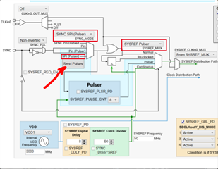

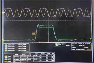

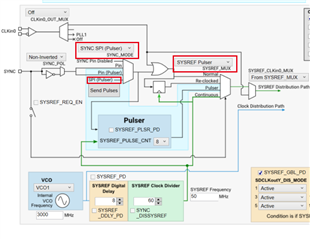

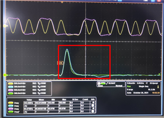

I met a new problem when I config SYSREF signal with 'SYNC SPI (Pulser)' mode(Figure 1), but when I catch the signal the SYSREF changed like a spur with overshoot at the falling edge(Figure 2) although the device clocks are sync. When I disable the SYSREF, the siganl is normal(Figure 3). I don't understand why?

    Are you using the 'SYNC SPI (Pulser)' mode setting for generating the SYSREF output in Pulser mode? This is not feasible and "SYNC SPI Pulser" setting is needed for SYNC input through SPI for synchronization.
    Please follow the section 9.3.1 and 9.3.2 in the datasheet for SYNC and SYSREF generation in various mode.

  • Hi Ajeet,
    Yes I use 'SYNC SPI (Pulser)' mode, because I saw that this choice in datasheet, and in this mode, I don't need external SYNC input signal but pulser from VCO.
    What you mean is this mode can not work or my method is wrong? About this point I don't understand because after I use SPI signal to control SYSREF pulse generation, I get the aligned device clock signal(like Figure 2).

  • Hi Nan Li,
    Sorry there was an error in last comment, as SYSREF in pulser mode can be generated through SYNC_MODE set with SYNC SPI (pulser) setting and write the 0x13E register (click at send pulses) with the number of pulses.
    I am not clear on the SYSREF disable mode and get the SYSREF waveform. When SYSREF is configured in pulser mode, it should generate number of pulses mentioned in 0x13E register with send pulse command.
    The SYSREF disable mode is that I can send SYSREF signal when I toggle the 'Send Pulser' button but this SYSREF signal don't 'work' (it will not influence the Device Clock, will not sync the device clock signal, it just a signal without any funcion).

    The SYNC/SYSREF path is shared, so SYSREF signals can reset the divider and SYNC signals can buffer through to the SYSREF outputs. If you have SYNC_DISx bit cleared when you generate a pulse on the SYSREF pulser, it resets the other clocks. If you have SYNC_DISSYSREF bit cleared when you generate a pulse on the SYSREF pulser, it resets the SYSREF divider, which can cause the pulse to be too short. You should only clear the SYNC_DISx and SYNC_DISSYSREF bits when you are prepared to interrupt and reset the channel/SYSREF dividers for phase synchronization. After the initial SYNC event that establishes a specific phase relationship between device clocks and SYSREF, you should set the SYNC_DISx bits and SYNC_DISSYSREF to prevent the dividers from being reset on the SYSREF pulser event.
    This might not be an issue, but for completeness: You can also use the SYSREF_GBL_PD bit to hold a SYSREF output low or at common mode voltage while a SYNC event is happening, to prevent the SYNC pulse from buffering out through the SYSREF outputs. This is effectively a "mute" control, so SYNC events at the LMK04828 do not accidentally get interpreted as SYSREF events at the devices to be clocked.
