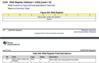

    You can also readback the phase offset from the following registers.
    For DPLL1:
    DPLL1_REF_SYNC_PH_OFFSET can be used to readback the DPLL1 REF zero delay mode phase offset. DPLL1_REF_SYNC_PH_OFFSET is made up of the following registers: 0x18E[4:0], 0x18F, 0x190, 0x191, 0x192, 0x193. Below is an image of the LSBs.
    For DPLL2:
    DPLL2_REF_SYNC_PH_OFFSET can be used to readback the DPLL2 REF zero delay mode phase offset. DPLL2_REF_SYNC_PH_OFFSET is made up of the following registers: 0x219[4:0], 0x21A, 0x21B, 0x21C, 0x21D, 0x21E. Below is an image of the LSBs.
    These register can be found in the LMK05028 register map: https://www.ti.com/lit/ug/snau233/snau233.pdf?ts=1636125887948&ref_url=https%253A%252F%252Fwww.ti.com%252Fproduct%252FLMK05028

  • Hello Kia
    I think the DPLL2_REF_SYNC_PH_OFFSET and DPLL1_REF_SYNC_PH_OFFSET are use to set an phase-offset between input and output if we want to control or calib phase.
    I want is read the current phase between output 1PPS and input 1PPS from ZDM TDC. Can LMK05028 support it,
    Phi Tu
  • Hello Phi Tu,
    Unfortunately, there is not a register to readback the current phase offset. With that being said, the input-to-output phase offset (tPHO) will be repeatable after exiting holdover, after a switchover event, and after device start-up. The typical tPHO is 2 ns.
    If you would like to know the exact phase offset, a manual measurement must be performed.
