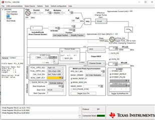

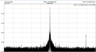

I am seeing some large (~ -60 dBc) at strange offsets when using the LMX2594.  The image below is a spur with an offset of 39.281 MHz and is 63 dBc.  This measurement was taken on the LMX2594 eval board with a 250 MHz clock and a Fpd of 125 MHz.  The TICS Pro settings follow the measurement.  Do you have any ideas what this spur is from or how to reduce it?
  • Josh,
    This is a huge spur, and I'm not sure what's causing it. Nothing about your configuration suggests it should be there.
    Usually when we see very large out-of-place spurs like this, we suspect a few possibilities:
    • The power supply could have some free-running microcontroller inside adding a spur at a very high offset which no one noticed before - try switching the power supply
    • The USB2ANY can sometimes carry noise over from the host PC - try the measurement with the USB2ANY disconnected, after loading register settings
    • Try setting the OUTB_MUX to VCO as well - this shouldn't have a large effect but it's something to try
    • Confirm that the spur is still present even when the carrier is removed - might be an artifact on the spectrum analyzer
    Test these and let me know what you see.
    Derek Payne
  • It appears to be the spectrum analyzer.  I tried using a different company's spec an and the spur went away.  I still see the smaller spurs (~ 70 dBc) but I think those are expected.  I read some forum entries that suggested using the MASH_SEED field to lower those spurs.  I had some questions about that.
