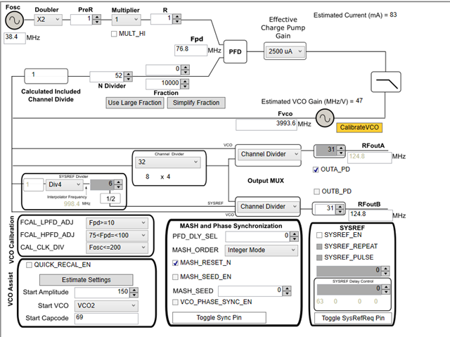

Hi team,
One of our customers encountered a problem when using LMX2572. There are many harmonic signals output. In their application, 38.4M single ended clock signal is used to input and output 124.8M clock. The configuration is generated by TICS Pro software, and then the configuration is imported into LMX2572. In addition to 124.8M clock, there are many other frequency signals, as shown in the following figure:
When VCO is configured as 3.9936g output, the spectrum is displayed as follows:
Register configuration:

  • Hi Amy,
    This is an integer channel, there will no fractional spurs, but there may be spurs at multiples of 38.4MHz offset due to the internal state machine clock. Please try, after the VCO is locked, program R2[0] = 0 to stop the state machine clock.
    At this low frequency output, the VCO got divided down, so the output signal waveform is a square wave. As a result, there will be many harmonics.
    Something I don't understand from your plots. In the first plot, you've got a very strong signal at 2GHz. in the second plot, the 3.9GHz signal was also very big. Is there something wrong with the spectrum analyzer setup?
  • The customer feedback:
    1. Although the 124.8M clock contains many harmonics, it seems that there is no problem when input to the later PLL and can work normally.
    2. In the above plots, 2GHz signal is not displayed on the spectrometer, only 124.8MHZ channel divider and VCO 3.9936G output
  • Hi Amy,
    Harmonics is not a flaw, as long as it is a square wave, it will be harmonic rich.
